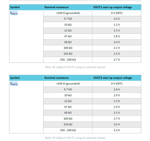

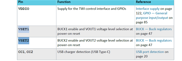

For a project with nRF9151 as the main microcontroller, we use nPM1300 for power management.
As I understand, for nRF9151, VDD voltage should be supplied prior to VDD_GPIO voltage.
VDD is supplied from VSYS on nPM1300 and VDD_GPIO is supplied from VOUT2 on nPM1300.
How is the timing between VSYS and VOUT2 for nPM1300? Will there be any delay?
