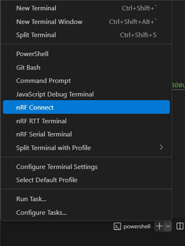

  • Hi, you can use nRF Connect for VS Code and choose the "nRF Connect" profile
    or you can run "nrfutil sdk-manager toolchain launch --ncs-version v3.1.0 --terminal" (or whatever ncs version that you are using if it's newer than 3.0)
    The error that you are seeing is most likely because the environment is not properly set up for west
    Run these is you still run into errors for me to see what's wrong.
    where west
    west --version
