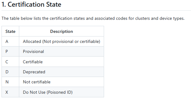

zap-gui and matter spec inconsistency
Using the matter weather station as a base on a thingy53 and SDK 3.1.0 which should use matter 1.4.2
if i open zap-gui and try and add a Control Bridge (0x0840) i get notification
WARNING On endpoint 4, support for cluster: Scenes Management client is provisional.
according to the matter spec in 1.4.2 Scenes Management isn't provisional anymore, is this a bug or am i somehow on a different matter version
also If i try to add a Timer(0x0047) Cluster to the Control Bridge i get
WARNING On endpoint 4, support for cluster: Timer server is provisional.
I cannot find a timer cluster anywhere in the Matter specs not in the List of Provisional Items or anywhere else
can someone point out where in the specs this is or where else it comes from?
thx
