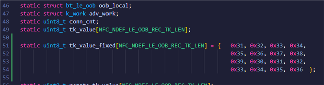

  • I use a fixed tk_value instead of generating random TK.

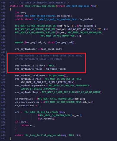

  • Replaced all usage of tk_value with tk_value_fixed, including in the record payload.
  • In the OOB record payload, I did not provide le_sc_data, to enforce Legacy Pairing.

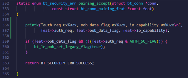

  • In the pairing_accept callback, the SC flag in auth_req is still set, and oob_data_flag = 0.

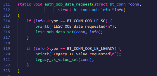

  • The auth_oob_request callback is never called.
