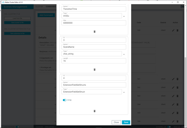

    I was not able to reproduce this. That is, selecting array as the argument type was successfully added to the generated .xml:
    Could you please share some more details? I.e. are you not able to choose array from the type menu, or are you expecting there to be an "array" toggle for your argument? As far as I can tell there are no way to implement the array toggle feature in the current version of the Matter Cluster Editor.
    to be more clear I am talking about arrays of struct
    I know these are possible as they are used in the spec
    e.g Scenes Management Cluster(external/modules/lib/matter/src/app/zap-templates/zcl/data-model/chip/scene.xml)
        <command source="client" code="0x00" name="AddScene" response="AddSceneResponse" isFabricScoped="true" optional="false" cli="chip scenes add">
          <description>Add a scene to the scene table. Extension field sets are input as '{"ClusterID": VALUE, "AttributeValueList":[{"AttributeID": VALUE, "Value*": VALUE}]}'.</description>
          <arg id="0" name="GroupID" type="group_id"/>
          <arg id="1" name="SceneID" type="int8u" max="254"/>
          <arg id="2" name="TransitionTime" type="int32u" max="60000000"/>
          <arg id="3" name="SceneName" type="char_string" length="16"/>
          <arg id="4" name="ExtensionFieldSetStructs" type="ExtensionFieldSetStruct" array="true"/>
          <access op="invoke" role="manage"/>
        </command>
    if i load this cluster into Matter Cluster Editor  0.1.0  it is shown
    however there is currently no way to set this for a new argument that i can find, other than manually editing the xml file
    This is not supported by the Matter Cluster Editor v0.1.0. You will need to manually add this to the .xml file. Apologies for the inconvenience.
