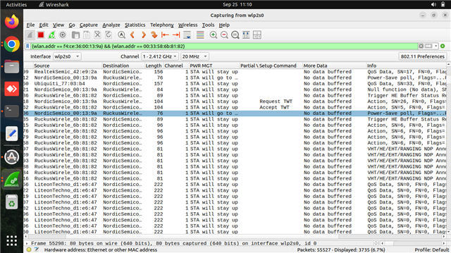

TWT connection established is with flow type announced and no Trigger enabled.
Nordic STA sends PS poll for every wake up to inform AP since TWT connection is announced with trigger disabled.
This is expected behaviour after every warm boot.

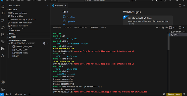

Hi Amsnda,
As you advised, we followed this guide (https://academy.nordicsemi.com/courses/wi-fi-fundamentals/lessons/lesson-2-wifi-fundamentals/topic/lesson-2-exercise-1-2/), but we are facing the issue 'Wi-Fi interface not up'.
Please find the attached screenshot for your reference.

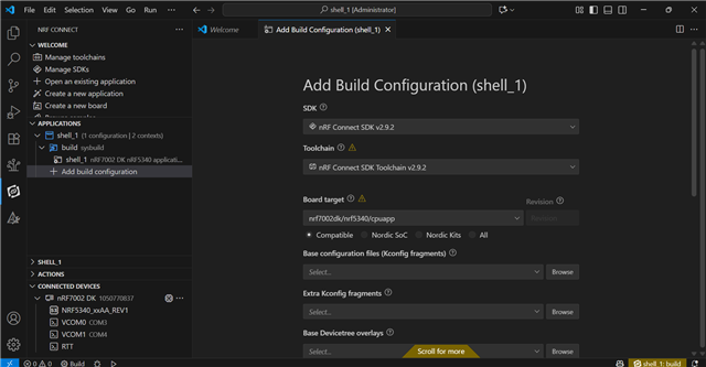

While adding the build configuration, it is asking for some options. Could you please suggest which options we need to provide?
