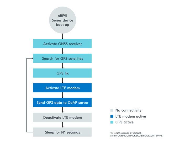

For more context, I'm following the nRF91 simple tracker solution, but instead of using CoAP, I used MQTT instead, which is in Lesson 4 of the same course. The way I switch from LTE and GNSS is the same as the exercise flowchart (attached below).

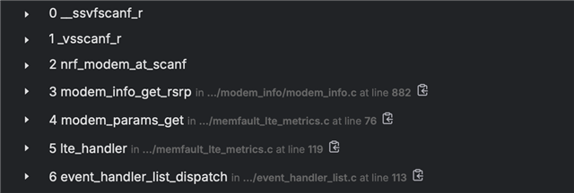

    I decided to enable Memfault shell to manually export the coredump. Here is what I found:
    The stack trace is essentially:
    __ssvfscanf_r
     _vsscanf_r
    nrf_modem_at_scanf
    modem_info_get_rsrp (nrf/lib/modem_info/modem_info.c:882)
    modem_params_get (nrf/modules/memfault-firmware-sdk/memfault_lte_metrics.c:76)
    lte_handler (nrf/modules/memfault-firmware-sdk/memfault_lte_metrics.c:119)
    event_handler_list_dispatch (nrf/lib/lte_link_control/common/event_handler_list.c:113)

    After connecting to LTE, I follow the similar behavior in my loop to disable it to switch to GNSS. Reference from this sample code. I'm just wondering if it would be the cause? For example, if memfault is collecting lte metrics, and the modem_info.c:882 calls AT command, would it cause the modem to crash/hang?

  • Thank you so much! I looked into the zephyr.map and zephyr_final.map and the PSP address falls into the range for the work_q_stack.
    .noinit."WEST_TOPDIR/nrf/lib/lte_link_control/common/work_q.c".0
                    0x0000000020013d10      0x400 modules/nrf/lib/lte_link_control/lib..__nrf__lib__lte_link_control.a(work_q.c.obj)
                    0x0000000020013d10                work_q_stack
    I increase the stack size to CONFIG_LTE_LC_WORKQUEUE_STACK_SIZE=2048
    Still not sure why the crash log and addr2line didn't print out this info but everything works now! Thanks again!
