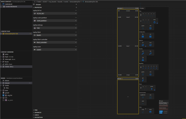

In the exercise, the visual editor “provides an overview of the devicetree context and a visual representation of the devicetree structure of your project”. However, when I click on the Devicetree Visual Editor, I get nothing. I get the four panels on the left: Build Contexts, Context Files, Context Overview, Nodes – all empty (except for their descriptions). So, I can assume that it is not linked to the project that I have open and built. I don’t see any + button or equivalent for adding or linking any file.

    For the device tree visual editor to "link", you need to actually click on the specific build that you need to set it as you active build context. This is to ensure that for projects with multiple builds, the correct device tree and configs will be pulled up.
    So, click on the build that you created under your build folder and then try Device Tree Visual Editor again or press on Devicetree like in the exercise.
    You should see everything that you need.
    And since you are working with the nRF54L15, I suggest you move on to exercise 2 to speed up the process
