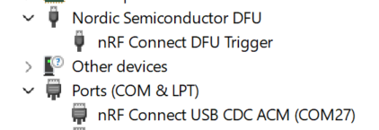

Device Manager shows the following while trying to connect:

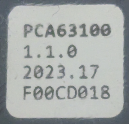

  • Hi Dejan,
    Thanks for continuing to follow up.
    I have and have had only the one PPKII unit.
    Here is a photo of the sticker on it, the version and date code on it match the sticker on the box:
    PCA63100
    1.1.0
    2023.17

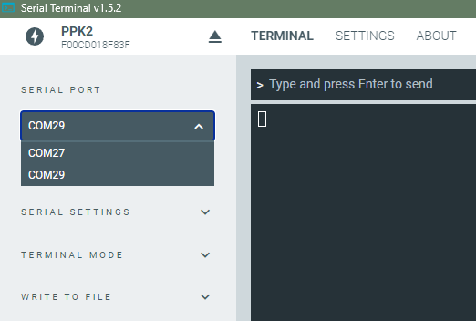

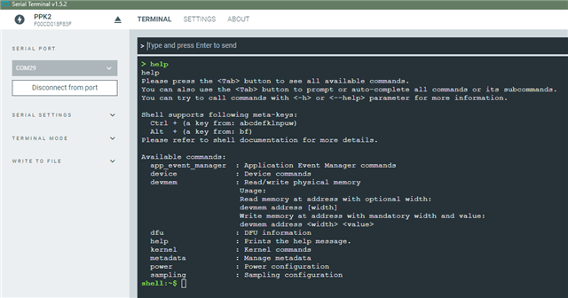

    Can you please enable Verbose logging in the Power Profiler application (About -> Verbose Logging) and share the log?
    Additionally, PPK VCOM0 is used for PPK data and VCOM1 for debug shell. Can you check and verify that VCOM1 is used as Zephyr shell by connecting to it using Serial Terminal and observing shell prompt 'shell:~$' ?

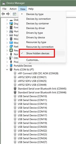

    When I connect via serial port, I don't have VCOM0 and VCOM1.  I have VCOM27 and VCOM29.  I assuming this is ok as the COM ports just increment as new devices are used.
    I can connect to the Serial Terminal, and once connected I can change from VCOM27 to VCOM29.  VCOM29 comes up with the shell.  Pictures below.

  • HI Dejan,
    Great news!  I was able to fix the issue and it works now.
    After you had told me to check the COM ports 0 and 1 and saw that mine were 27 and 29 (I didn't find it strange that they were higher numbers), but I did think it strange that they weren't consecutive.  Assumed that 28 must have already been taken somehow, but decided to see if this was the issue.
    I did some reading on how to reset the COM numbers.  I tried messing with the COM Port Arbiter in the Registry, but this just freed-up or changed the numbering (didn't impact the installed devices).
    I had previously tried uninstalling the COM ports (and drivers) from the device manager while connected to the device and it didn't help anything (they came back with the same numbers).
    I found a tip that you can enable hidden devices in the device manager.  This let me see all the COM ports including the PPKs while not connected to it.  I uninstalled 27, 28 and 29 and then reconnected.  I noticed the COM ports changed from 27 and 29 to 27 and 28.  However, it still didn't work.
    I then realized when scanning down the list that COM27 was in the list twice.  No idea how this happened, but removed both 27s and 28 again and reconnected and now it works!
