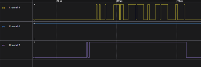

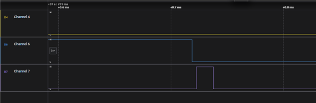

  • Hello Edvin,
    I have made progress in implementing this interface, but found some confusing behavior. First when looking into the nrfx_spim.h file, for NRFX_SPIM_FLAG_HOLD_XFER, it states "Chip select must be configured to @ref NRF_SPIM_PIN_NOT_CONNECTED and managed outside the driver." What does this mean? Am I expected to setup a GPIO to also be triggered via GPPI for my SPI driver separately.
    Second, I was able to setup the GPPI interface correctly, but I am using GPIOTE instead of the timer. Our IMUs have an interrupt line which are triggered cyclically, so it serves the same purpose. The problem I am having is that when I try to schedule a repeated transfer to be used on each GPIOTE interrupt, the full SPI MOSI transmission is not being sent. Any ideas?
    Here are some waveforms:
    Channel 4 (Yellow): SPI MISO
    Channel 6 (Blue): IMU Interrupt Line
    Channel 7 (Purple): SPI MOSI
    (Previous) Healthy SPI Communication (Polled) with No Interrupts
    (Current) IMU Interrupt GPIOTE Triggered SPI Communication
    From above, it seems my GPIOTE linkage with the GPPI interface is working: every IMU interrupt is followed by an attempted SPI transmission. The SPI transmission is only a high for a few moments, and then low. It should be sending the value 0x8C = 0b1000 1100. See code below:

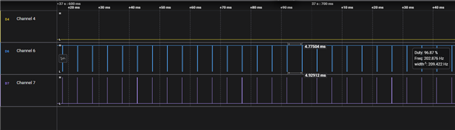

  • Here is a zoomed out picture of the GPIOTE working with SPI.
  • Update on this, I realized that my logic analyzer was sampling at 6.25 Mb/s while the SPI bus is operating at 8MHz, so the communication is fine. The logic displayer was just aliasing data. At the moment, I have most of the driver working with the following two GPPI pipelines.
