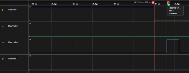

    One final question: When testing the module, I did not do as the driver instructed. The driver states to leave "Chip select must be configured to @ref NRF_SPIM_PIN_NOT_CONNECTED and managed outside the driver."  Instead, I configured it to pin 69. See below.
    #define SPI_CLK_PIN_201      65
    #define SPI_MOSI_PIN_202     66
    #define SPI_MISO_PIN_204     68
    #define SPI_CS_PIN_205       69
    #define SPI_INSTANCE_IDX     00
    const nrfx_spim_t spiDev = NRFX_SPIM_INSTANCE(SPI_INSTANCE_IDX);
    nrfx_spim_config_t spiConfig = {
            .sck_pin = SPI_CLK_PIN_201,
            .mosi_pin = SPI_MOSI_PIN_202,
            .miso_pin = SPI_MISO_PIN_204,
            .ss_pin = SPI_CS_PIN_205,
            .ss_active_high = false,
            .irq_priority = NRFX_SPIM_DEFAULT_CONFIG_IRQ_PRIORITY,
            .orc = 0x00,
            .frequency = NRFX_MHZ_TO_HZ(8),
            .mode = NRF_SPIM_MODE_0,
            .bit_order = NRF_SPIM_BIT_ORDER_MSB_FIRST,
            .miso_pull = NRF_GPIO_PIN_NOPULL,
            .ss_duration = 5UL,
            .dcx_pin = NRF_SPIM_PIN_NOT_CONNECTED,
            .use_hw_ss = true,  // TODO LR: Not sure if this should be true
            .rx_delay = 2UL,
        // Perform Reconfigure
        nrfx_err_t err = nrfx_spim_reconfigure(&spiDev, &spiConfig);
        if (err != NRFX_SUCCESS) {
            printk("[SPI] FAILURE: Reconfiguration Failed\n");
    Despite this, the device seems to operate fine. When scoping the lines, the CS functions appropriately. Is there any consequence or negative side effect if I keep it this way? Why does this work?

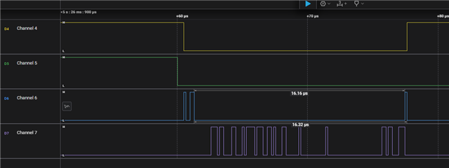

    Channel 4 (Yellow) - SPI CS
    Channel 5 (Green) - IMU Interrupt
    Channel 6 (Blue) - SPI MOSI
    Channel 7 (Purple) - SPI MISO
  • I guess the SPIS device that you are using accepts that the CS pin is set at the same time as the MOSI starts outputting data. Some devices uses this as a wakeup source to trigger some task, and is not ready to receive data before a certain amount of time has passed.
    How do you trigger the CS pin? Is it being done by the driver, or do you do it using the fork and PPI?
    BR,
    Edvin
  • Yes, that makes sense. my device only needs 40ns for CS setup/hold time. Upon closer inspection of the waveform there is a 60ns hold time.
    For my code, the CS is being trigger by the driver. Is the CS being triggered (almost) at the same time as the MOSI why the documentation states to handle the CS outside the driver? Can I leave it like this?
  • Ok, I thought you controlled it using PPI directly (PPI + GPIOTE), but it seems like the driver handles this, yes.
