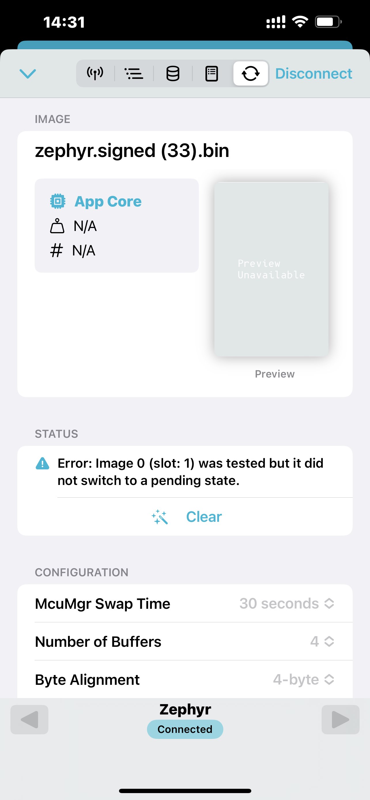

Question 1.
 I used the nrf connect firmware to download to the mcuboot_third area in the Hub, but the nrf connect tool reported an error.
This is a custom.yml file.

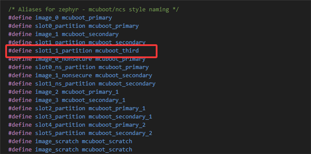

I made some changes to flash_map_pm.h and zephyr_img_mgmt.c.
flash_map_pm.h:
zephyr_img_mgmt.c:

Question 2:
Is the terminal's OTA solution feasible? Currently, the only way to perform firmware OTA for Aura is through the Hub. If not, how should I update the firmware for the terminal?
Thanks.
