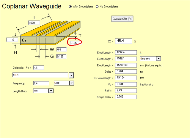

50 ohms coplanar

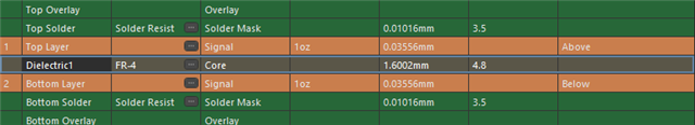

I am new to Nordic and want to design with the nRF52840. I have read this guide:
 General PCB design guidelines for nRF52 series

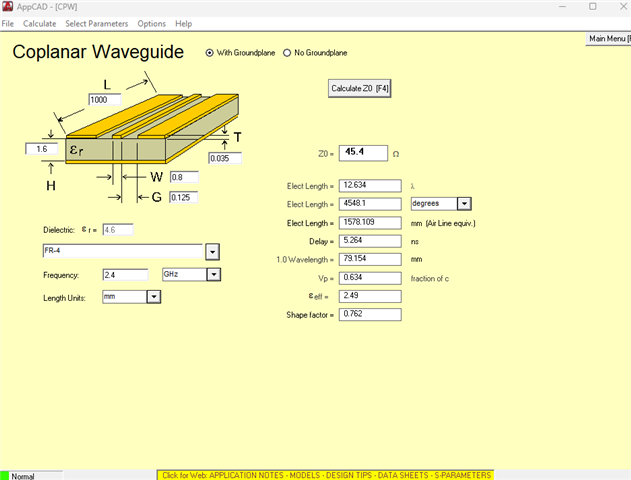

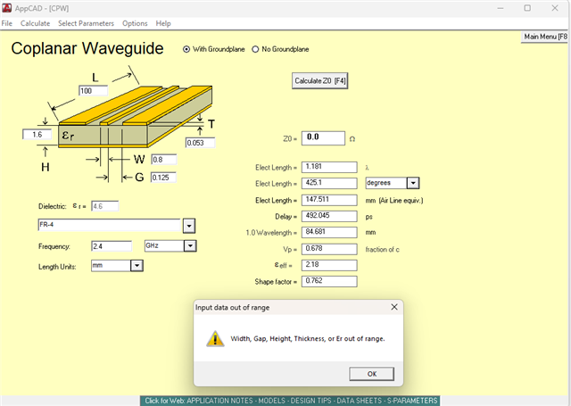

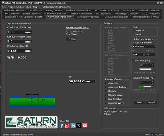

used AppCAD to find the best width and clearance for the ground layer, but when I downloaded the default example:

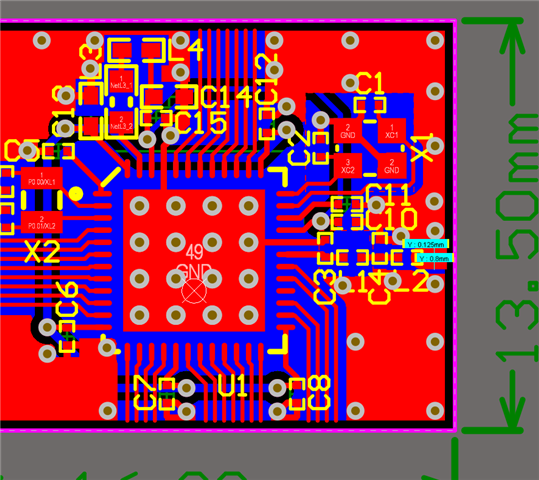

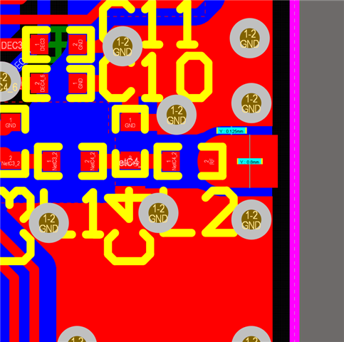

https://nsscprodmedia.blob.core.windows.net/prod/software-and-other-downloads/reference-layouts/nrf52840/nrf52840-qfaa-reference-layout-1_0.zip
W = 0.8 and G = 0.125 in AppCAD
The impedance is 45 ohms; is it OK, or did I make a mistake in calculating this?
