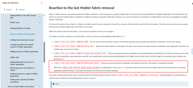

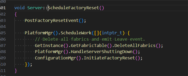

  • When the ScheduleFactoryReset() function is called by default during a factory reset, it should clear the NVM (Non-Volatile Memory) data. However, we are encountering an issue: even after invoking this function, the value of the TotalOperationalHours attribute fails to be cleared. Could you please help explain why this happens?
    Which version of the nRF Connect SDK are you using? Do you see this in an SDK sample or a custom application? Are you storing the TotalOperationalHours somewhere yourself?
    I cannot reproduce the issue on my side. In my tests, TotalOperationalHours is set to 0 after doing a factory reset, even without manually calling StoreTotalOperationalHours().
