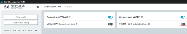

    Note that if you are using a DK, the debugger still try to control the UART20 flow control pins. To disable this, use the Board Configurator tool in nRF Connect for Desktop:
    I am 90% sure it is the VCOM0, but try to disable VCOM1 as well if it doesn't work.

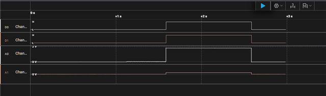

  • Try to uncomment this part of your nrf54l15dk_nrf54l15_cpuapp.overlay file:
    &uart20_sleep {
        group1 {
            psels = <NRF_PSEL(UART_TX, 1, 4)>,
                    <NRF_PSEL(UART_RX, 1, 5)>;
            low-power-enable;
    I didn't test the UART command, but I added this to the main() and right before the main() function in main.c:
    #define LED13_NODE DT_PATH(leds, led13)
    #define LED14_NODE DT_PATH(leds, led14)
    static const struct gpio_dt_spec myled13 = GPIO_DT_SPEC_GET(LED13_NODE, gpios);
    static const struct gpio_dt_spec myled14 = GPIO_DT_SPEC_GET(LED14_NODE, gpios);
    void test_gpio_13_14(void)
    	int ret;
    	if (!gpio_is_ready_dt(&myled13))
    		return;
    	ret = gpio_pin_configure_dt(&myled13, GPIO_OUTPUT_ACTIVE);
    	if (ret < 0)
    		return;
    	if (!gpio_is_ready_dt(&myled14))
    		return;
    	ret = gpio_pin_configure_dt(&myled14, GPIO_OUTPUT_ACTIVE);
    	if (ret < 0)
    		return;
    	gpio_pin_set(myled13.port, myled13.pin, 1);
    	gpio_pin_set(myled14.port, myled14.pin, 1);
    	k_sleep(K_MSEC(1000));
    	gpio_pin_set(myled13.port, myled13.pin, 0);
    	gpio_pin_set(myled14.port, myled14.pin, 0);
    	printk("Starting Radio Test sample\n");
    	test_gpio_13_14();
    	clock_init();
    And when I uncommented the uart20_sleep in the .overlay file, it worked as intended:
    (these are pins P1.06 and P1.07)
    For reference, here is the entire, modified application project:
    radio_test_f.zip
    Edvin
