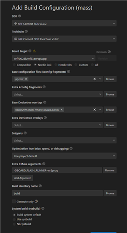

And setup following build configuration
But it doesn't compile :

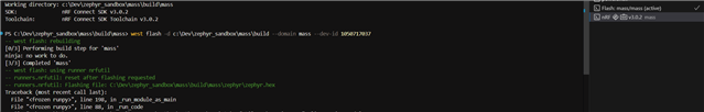

    Thank you, now it compiles! But I can't flash. The nRF Connect extension keeps using nrfutils which doesn't work due to protobuf version conflict. If I change the flash runner to nrfjprog via extra cmake argument AND CmakeLists.txt, but it keeps using nrfutils
    It is the first time I try a sample since I started development on that SDK. My main project does use nrfjprog without even having to tell it to do so. Both sample and main project are with ncs3.0.2.
    Why is this behavior inconsistent (and non-working)?
    Thank you for your help

    As I said, nrfutil doesn't work due to protobuf version. It ask for protobuf < 3.20 but my installation of python 3.12 and more precisely grpcio-tools ask for protobuf >=5.26.1 so requirement is impossible to meet. If you have an actual solution to this, it would be great. Here is the complete error log :
      File "C:\Users\AppData\Local\Programs\Python\Python312\Lib\site-packages\nordicsemi\dfu\dfu_cc_pb2.py", line 32, in <module>
        _descriptor.EnumValueDescriptor(
      File "C:\ncs\toolchains\0b393f9e1b\opt\bin\Lib\site-packages\google\protobuf\descriptor.py", line 920, in __new__
        _message.Message._CheckCalledFromGeneratedFile()
    TypeError: Descriptors cannot be created directly.
    If this call came from a _pb2.py file, your generated code is out of date and must be regenerated with protoc >= 3.19.0.
    If you cannot immediately regenerate your protos, some other possible workarounds are:
     1. Downgrade the protobuf package to 3.20.x or lower.
     2. Set PROTOCOL_BUFFERS_PYTHON_IMPLEMENTATION=python (but this will use pure-Python parsing and will be much slower).
    More information: https://developers.google.com/protocol-buffers/docs/news/2022-05-06#python-updates

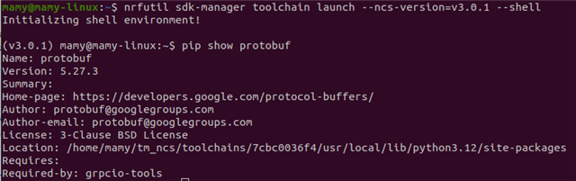

    Did you install the nRF Connect SDK toolchain manually or using nrfutil or VS Code?
    Do you use the nRF Connect SDK for VS Code extension to build and flash?
    If you installed the toolchain using nrfutil or VS Code, then the VS Code extension should use this toolchain, including the python version bundled with the toolchain.
    Can you launch the toolchain with nrfutil and check which protobuf version is used?
    nrfutil sdk-manager toolchain launch --ncs-version=v3.0.2 --shell
    pip show protobuf
    For example, here you can see that v3.0.1 uses protobuf 5.27.3:
    Marte
