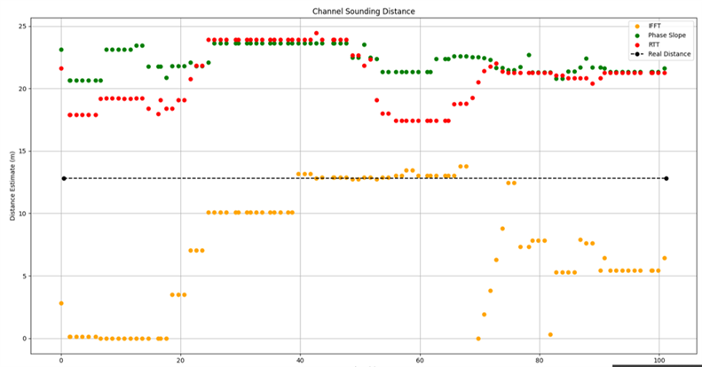

I noticed that the distance accuracy (for example, using the IFFT) is not as precise as I expected (see the graph below).

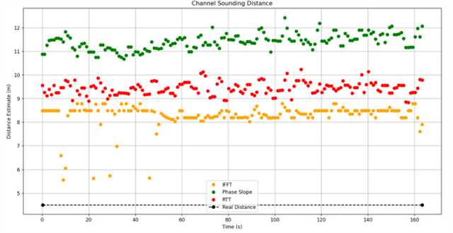

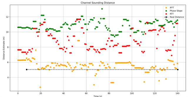

I tested with real distances of 5 m and 4.5 m, but the measured values were significantly different — with more than 4 m of error for the 4.5 m test. I am a bit confused about this behavior.
I also performed a test at 13 m in another environment, this time with more Bluetooth devices nearby that could generate interference. However, the IFFT results were very irregular, and I find it difficult to understand its behavior.

    So first of all, CS isn't UWB; the best you can expect is ±0.5m. So the distance is progressing in steps. The way it almost seems that you've made it do on the bottom 13m test(?) might be a good way to look at it. Differentiating between ±0.5m would be impossible/hard.
    Secondly, it is tempting to simply say that you should disregard anything but the IFFT measurement - which I would also claim performs ok-ish in the tests you've shown (although I am not so sure why it bounces down to 0 in the 13m test). IFFT might be the most developed algorithm, but the truth is rather that all of these metrics work best in different situations. RSSI is okay in short range for instance, and RTT is best for very long ranges. This old webinar (which is meant to describe how our old "Distance Toolbox" worked, but the tech is almost the same) goes a bit further into the details of what separates these measurements. Another thing I just realized when finding the webinar now is that phase slope might get you a max range, but don't quote me on that.
    Most importantly: if you really want a good accuracy for your product, what you would typically do is to buy a third party algorithm that gets you a better accuracy than what our free code does. I assume the better algorithms combine all of these metrics in some fancy way. If you contact your local regional sales manager I bet he would be able to put you in contact with someone selling third party CS algorithms.

    To come back to the 13 m test, I understand that the distance progresses in steps, but I was surprised by how long it takes to reach an acceptable level of accuracy.
    Also In that setup, the initiator and reflector were in different rooms, about 13 m apart — can Channel Sounding still work properly under those conditions?
    It would impact it, though bodies (or anything containing water) would typically impact it more. So the question is rather how much accuracy you need, given your use case.

  • It looks like what is called "average" is actually a median filter. This works differently as outliers are ignored totally while in average they will impact the results. You use median filters here as one of the quirks of phase based ranging is that you can get suddenly get very wrong results caused by for instance multipath. With a median filter these are removed while with average they would "count".
    More advanced and tailored filtering can also be used if you need even better performance
