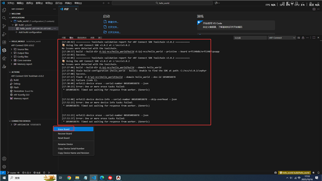

nRF52840/nRF5340 Development Boards Cannot Flash Programs After Using DEBUG Function
Error Report:
When flashing, I get this error:
Error:
One or more batch tasks failed: * 1050058878: Timed out waiting for response from worker. (Generic) FATAL ERROR: command exited with status 1: nrfutil --json device --x-ext-mem-config-file C:/ncs/v3.0.2/zephyr/boards/nordic/nrf5340dk/support/nrf5340dk_qspi_nrfutil_config.json x-execute-batch --batch-path 'D:\pj-ncs\hello_world\build\generated_nrfutil_batch.json' --serial-number 1050058878
This occurred while working on Exercise 1 of Lesson 2 (Debugging and troubleshooting) in the nRF Connect SDK Intermediate course. After following the instructions and clicking DEBUG:
  1. An error dialog appeared
  2. My board can no longer be flashed (even previously working programs fail)
  3. The J-LINK folder no longer appears when connecting the board to the computer
  4. Both erase and recover operations in VS Code failed (see attached logs)
  5. The same issue occurs with both nRF52840 and nRF5340 boards
Key points:
  • Problem started after debug attempt
  • Affects multiple boards
  • Basic recovery methods failed
  • J-Link communication appears broken
