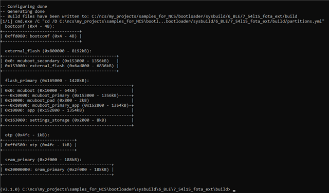

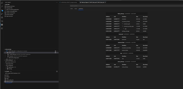

    1. Could you check your partition map with the VS Code tool for memory report?
    2. Could you first try to remove the static parittioning map and build with dynamic partitioning?
      Typically I recommend that you start your projects/the early phases of development with dynamic partitioning and when your getting closer to nail the final features and layout, then you can use the generated dynamic partitioning map found in the build folder as a foundation for the static map by simply copy/pasting the generated partition layout into a pm_static.yml.
    Andreas

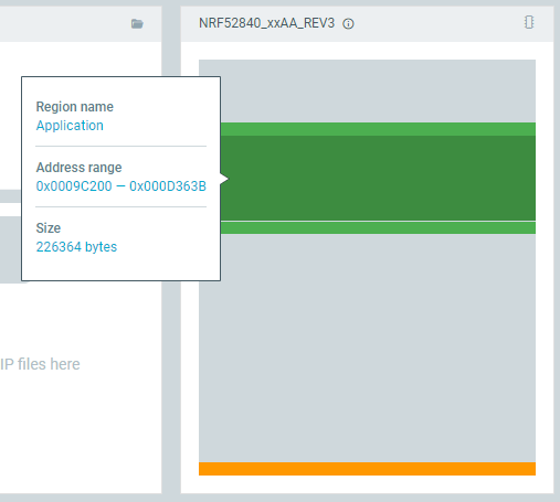

    Reading out the chip reveals, that the app is flashed to:
    app:
      address: 0x9c200
      end_address: 0xfa000
      region: flash_primary
    yes, the app boots without using MCUBoot, but with dynamic partitions.

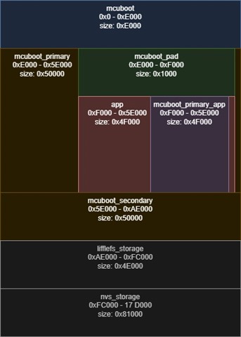

    --- EDIT: ---
    So after more and more hours I think I got it working together with AI and almost understand it fully.  I hope you can help me to get the final piece.
    This is my current pm_static.yml:
    # MCUboot bootloader
    # This is the immutable bootloader that runs at startup.
    mcuboot:
      address: 0x0
      placement:
        align:
          end: 0x1000
        before:
        - mcuboot_primary
      size: 0xc000 #size of bootloader
    # Primary image slot (active)
    # This is the full slot that includes both pad and app.
    mcuboot_primary:
      address: 0xc000
      orig_span: &id001
      - mcuboot_pad
      - app
      sharers: 0x1
      size: 0x40000 # size of primary app + mcuboot pad
      span: *id001 # Includes pad + app

    So after more and more hours I think I got it working together with AI and almost understand it fully. AHaug I hope you can help me to get the final piece
    Of course! I assume that the comments in the partition map is your notes/the findings that you and 'Kapa' (the AI assistant)

  • Thanks a lot.
    As the partition.yml is not so easy to read, I converted it into a diagram for others that may struggle to understand it.
    Please keep in mind that this is for the NRF54L15, which requires a larger mcuboot_pad
     such a diagram or example partition.yml would be very useful in the documentation for Partition Manager. Also a section where all default partitions are explained.
    Thank you for sharing the diagram. Though, there are tools already for this (per the first thing I wrote in this thread heh..) Although it doesn't draw it "pretty":
    This tool is also mentioned in the introduction/theory steps of the academy lesson about DFU and bootloaders
    You can also enter the build folder in cmd and use "ninja partition_manager_report" and get the output as:
