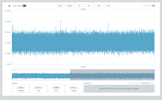

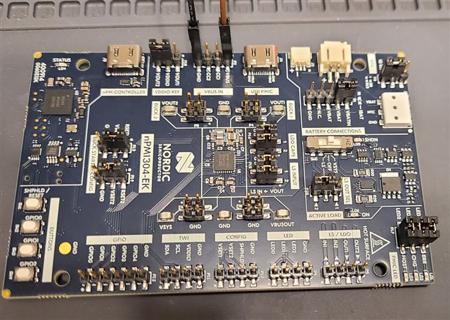

I'm trying to test the overall pwoer consumption of my setup (nPM1034EK and nRF54l15DK) using the PPK2.  As I've started this, I've gotten far higher numbers that I expected based on the documentation available.  I'm still working through optimizing the firmware (a different issue), so I disconnected the nRF54l15 completely.  I've set the jumpers and switches to the defaults per Jumpers and switches, disconnected the battery, and there's no USB connected to J4.  The PPK2 GND is connected to P2 GND and the PPK2 VOUT is connected to P2 VBUS on the EK.   The measurement is set up per Measure VBUS current, but the DK is disconnected and so the buck 2 pins are unused, as mentioned.  In PowerUP I have turned everything (Bucks, LDOs, etc.) off.  Running the PPK2 with this setup gives me the following output:
As you can see, the average current is 2.0mA.  I was expecting it to be much more like 4-8µA, based on information on Product overview and nPM1304 PMIC - nordicsemi.com.  What am I doing wrong?
