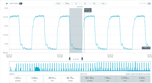

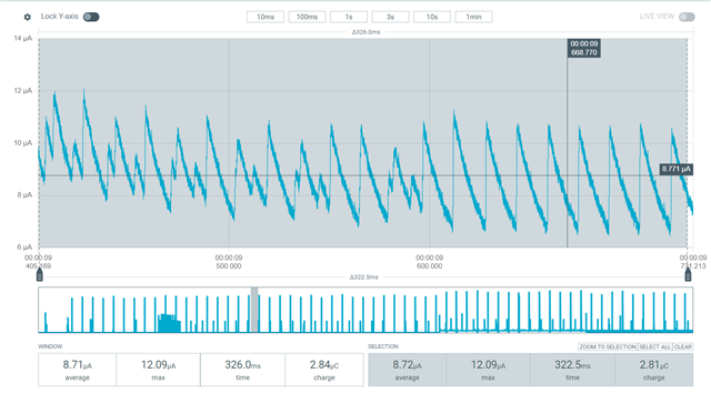

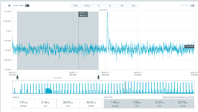

I have an LED connected, and I want to use PWM, but enabling it adds about 700 µA of passive current — both when the output is high and low. However, if I set the duty cycle equal to the period, the current consumption returns to normal.. Also, if I set the duty cycle to 0%, there is no additional current. What can i do to reduce this current?
