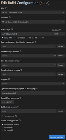

I am trying to test the lpuart functionality on our custom PCB and it doesn't work, but the issue is that by some reason even original samples from the SDK doesn't work.
I just take the sample Bluetooth: HCI low power UART - build it with no changes for the nrf52840 and flash to nRF9160DK nRF52840.
Then I take the Cellular: LTE Sensor Gateway - build it with no changes for the nrf9160/ns and flash into nRF9160DK to nRF9160.
And I get these errors:
[00:00:00.311,279] <wrn> lpuart: req pin low when expected high
[00:00:00.311,401] <err> lpuart: Empty receiver state:4
[00:00:01.053,436] <err> bt_gatt: Unable to import the key for AES CMAC -134

The build configuration is attached:
SDK 3.1.1
