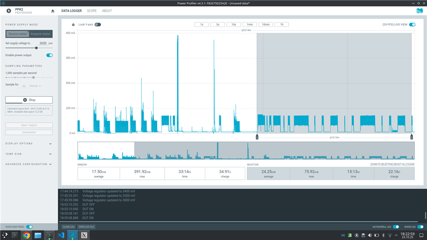

I’m working with an nRF9160-based device and have observed inconsistent LTE behavior when the device operates in areas with poor or unstable signal strength.
In low-signal environments, the modem repeatedly attempts to connect to the network. The sequence of LTE events varies between connection cycles.
Sometimes LTE_LC_NW_REG_UNKNOWN and LTE_LC_NW_REG_NOT_REGISTERED both come when the device is in a bad connection area, and sometimes only the LTE_LC_NW_REG_UNKNOWN event comes. If I don’t call lte_lc_func_mode_set(LTE_LC_FUNC_MODE_DEACTIVATE_LTE), then the pattern shown in the attached screenshot is observed.
If I call this function lte_lc_func_mode_set(LTE_LC_FUNC_MODE_DEACTIVATE_LTE) on UNREGISTERED event, then it works well and I can turn LTE back on after some time. However, the issue is that at low voltages, around or below 3.4 V, this function sometimes blocks the thread and never returns.
Also, as seen in the power profiler pattern the lte is trying to connect but the events are not triggered most of the time. For example, during the first attempt I see the LTE_LC_NW_REG_UNKNOWN and LTE_LC_NW_REG_SEARCHING events, but for the next 15 minutes, as shown in the screenshot, I only see one LTE_LC_NW_REG_NOT_REGISTERED event.
If I start LTE in an area where it cannot get a connection, the RRC first goes to CONNECTED, then IDLE after about 8 seconds, then LTE_LC_NW_REG_SEARCHING after a few seconds and then both events (LTE_LC_NW_REG_UNKNOWN and LTE_LC_NW_REG_NOT_REGISTERED) appear.
This makes it difficult to implement consistent application-level logic for managing LTE state transitions and power optimization.

    I have gone through the Cellular IoT course and also looked into the UDP sample. These are just basic LTE handling, I am talking about the exception where LTE is either very weak or is not available for several hours. I mentioned this already that LTE is trying to reconnect as you said, it is doing it automatically, I did not saved the logs for it but the behaviour was as I mentioned
    "Also, as seen in the power profiler pattern the lte is trying to connect but the events are not triggered most of the time. For example, during the first attempt I see the LTE_LC_NW_REG_UNKNOWN and LTE_LC_NW_REG_SEARCHING events, but for the next 15 minutes, as shown in the screenshot, I only see one LTE_LC_NW_REG_NOT_REGISTERED event."
    The issue here is that I dont want the modem to try a connection every few seconds when I know that the device is not going to get the connection for several hours, so to handle this I need a consistant behaviour and events from the modem so I can decide to turn off the modem and do not waste power as it is an IoT device. In the screenshot you can see that there is a pattern of modem trying to get the connection every few seconds/minutes but I can't find any documentation about it. So, can you please mention how can I set a custom pattern to try a connection may be every hour or a documentation about the events being generated during a connection loss so I can implement the logic according to it as the events I mentioned above are inconsistant.
  • Hi Muhammad,
    Thanks for the additional details. To control how often the modem searches for a cell, you can use the %DATAPRFL command to set pre defined profiles, or set the interval directly with %PERIODICSEARCHCONF. Alternatively, using the LTE link controller API, you can configure it with lte_lc_periodic_search_set().
    Benjamin
  • I guess, the names of the registration events are mixing more up. If you check the docu of the at commands, some may be clearer.
    +CEREG notifications:
    0 – Not registered. UE is not currently searching for an operator to register to.
    1 – Registered, home network
    2 – Not registered, but UE is currently trying to attach or searching an operator to
    register to
    3 – Registration denied
    4 – Unknown (for example, out of E-UTRAN coverage)
    5 – Registered, roaming
    90 – Not registered due to UICC failure
    e.g. LTE_LC_NW_REG_SEARCHING is used, when them modem "UE is currently trying to attach or searching an operator to register to". Together with "sticky rejection" the modem may report that only on the first search-runs, but maybe not in the follow up ones, when a network rejected the registration (see my old ticket ).
    All in all, if you want to have a feedback about "each search run", I use the modem sleep events when the modem is not registered. You may need to enable them in your prj.conf
    CONFIG_LTE_LC_MODEM_SLEEP_NOTIFICATIONS=y
    CONFIG_LTE_LC_MODEM_SLEEP_NOTIFICATIONS_THRESHOLD_MS=30000
    (all in all: the network search is one of the very frustrating functions of the nRF91. Years ago it was draining the battery searching for 9xxyy networks (HPPLMN), never ever finding one. Takes me months and tickets over tickets. I'm not sure, if the modem still stays idle without network because of the "rescue calls" as mentioned in the old ticket above. My main strategy: cfun=0 after 30 min and then activate it again, when you want to schedule a new network search for periods about 15 min. Inconsistent events and sticky rejection blocks any more advanced mechanism.)
