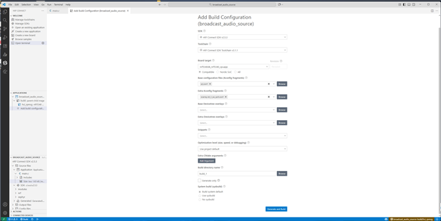

I've just come back to software development on Nordic after focusing on other projects, and since I last did any software development work, nRF Connect has been integrated as extensions n VS Code. I was hoping that there would be some online webinars explaining the new workflow but haven't found any. Can I suggest please that this would be very helpful?

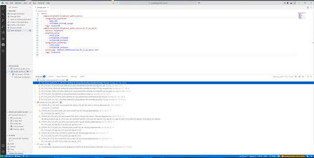

I tried building the Broadcast Audio Source project targeting the nRF5340 DK, but found numerous problems. I have attached screen captures of both the build configuration and the problems reported.
    The first potential source for errors is that your SDK version and toolchain version are different and quite far apart in version numbers. It is recommended to use the same or similar toolchain and SDK versions to ensure compatibility.
