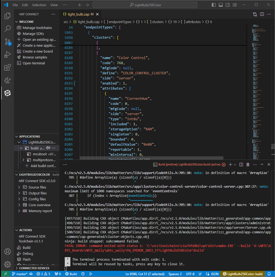

Error building Matter: light bulb with cluster color control
Hi, we need add the cluster color control to the project light bulb.

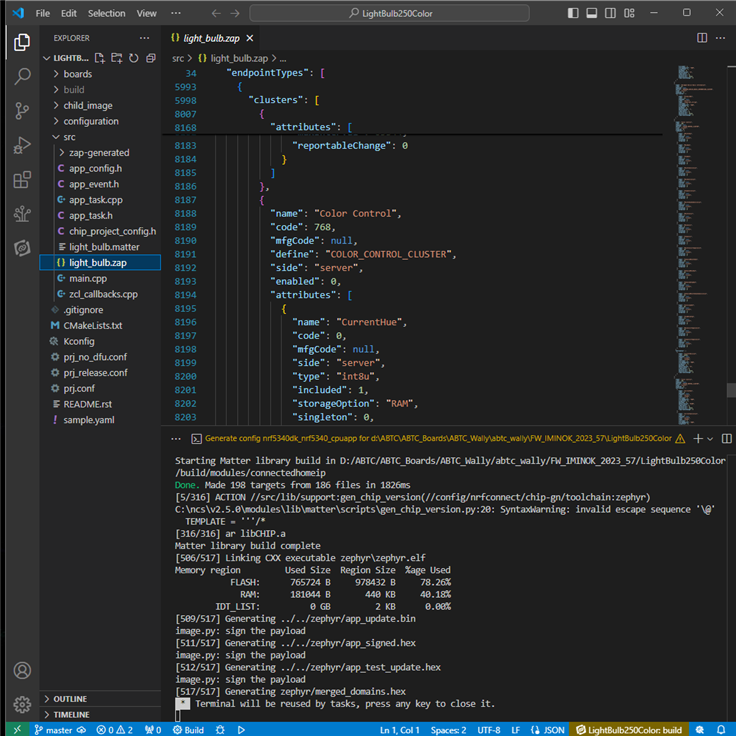

After add the build config and build the project for the firs time it build successfull:
But when change the line 8193 ( "enabled": 1 ) and do pristin build the terminal shows this error:
This the terminal output text:

C:/ncs/v2.5.0/modules/lib/matter/src/app/clusters/color-control-server/color-control-server.h:256:37: error: 'EMBER_AF_COLOR_CONTROL_CLUSTER_SERVER_ENDPOINT_COUNT' was not declared in this scope; did
you mean 'EMBER_AF_ACCESS_CONTROL_CLUSTER_SERVER_ENDPOINT_COUNT'?
  256 |     EmberEventControl eventControls[EMBER_AF_COLOR_CONTROL_CLUSTER_SERVER_ENDPOINT_COUNT];
C:/ncs/v2.5.0/modules/lib/matter/src/app/clusters/color-control-server/color-control-server.h:256:37: note: maximum limit of 1000 namespaces searched for 'EMBER_AF_COLOR_CONTROL_CLUSTER_SERVER_ENDPOIN
T_COUNT'

C:/ncs/v2.5.0/modules/lib/matter/src/app/clusters/color-control-server/color-control-server.cpp: In member function 'EmberEventControl* ColorControlServer::getEventControl(chip::EndpointId)':
C:/ncs/v2.5.0/modules/lib/matter/src/app/clusters/color-control-server/color-control-server.cpp:307:27: error: 'eventControls' was not declared in this scope; did you mean 'getEventControl'?
  307 |     if (index < ArraySize(eventControls))
C:/ncs/v2.5.0/modules/lib/matter/src/lib/support/CodeUtils.h:705:30: note: in definition of macro 'ArraySize'
  705 | #define ArraySize(a) (sizeof(a) / sizeof((a)[0]))
C:/ncs/v2.5.0/modules/lib/matter/src/app/clusters/color-control-server/color-control-server.cpp:307:27: note: maximum limit of 1000 namespaces searched for 'eventControls'
FATAL ERROR: command exited with status 1: 'C:\ncs\toolchains\c1a76fddb2\opt\bin\cmake.EXE' --build 'd:\ABTC\ABTC_Boards\ABTC_Wally\abtc_wally\FW_IMINOK_2023_57\LightBulb250Color\build'

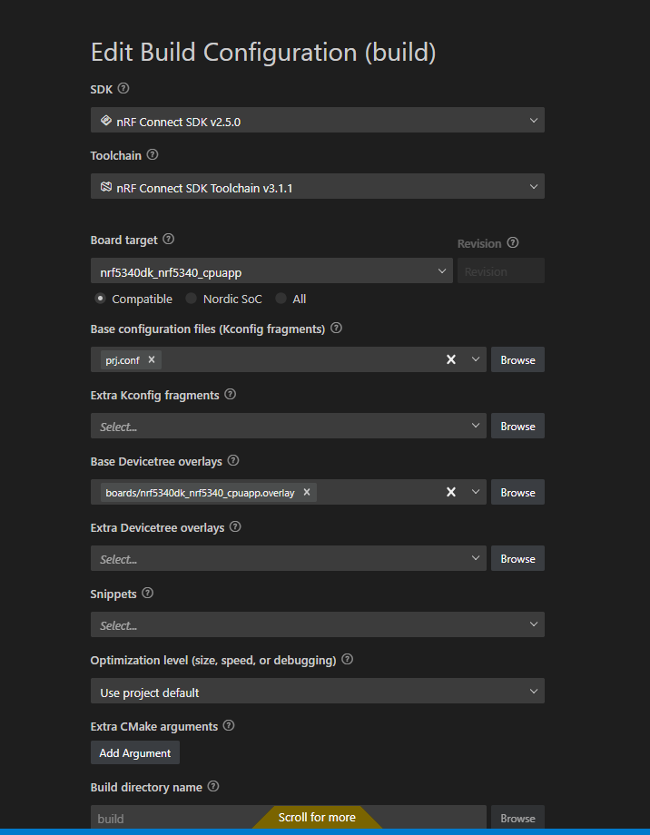

We use this config to build it.
Please, Could tell us whi happen this, or what are we doing wrong?
