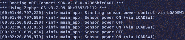

And current my main.c:
#include <zephyr/kernel.h>
#include <zephyr/device.h>
#include <zephyr/drivers/regulator.h>
#include <zephyr/drivers/sensor.h>
LOG_MODULE_REGISTER(main_app, LOG_LEVEL_INF);
void main(void)
    const struct device *sht_dev = DEVICE_DT_GET(DT_NODELABEL(sht4x));
    const struct device *ldsw1 = DEVICE_DT_GET(DT_NODELABEL(npm1300_ldsw1));
    struct sensor_value temp, humidity;
    int ret;
    if (!device_is_ready(ldsw1)) {
        LOG_ERR("LOADSW1 device not ready");
        return;
    if (!device_is_ready(sht_dev)) {
        LOG_ERR("SHT4x device not ready");
        return;
    LOG_INF("Starting sensor power control via LOADSW1");
    while (1) {
        /* Turn on sensor power */
        if (!regulator_is_enabled(ldsw1))
            ret = regulator_enable(ldsw1);
        if (ret) {
            LOG_ERR("Failed to enable LOADSW1: %d", ret);
            k_sleep(K_SECONDS(10));
            continue;
        LOG_INF("Sensor power ON (via LOADSW1)");
        k_sleep(K_MSEC(5)); // settle time
        ret = sensor_sample_fetch(sht_dev);
        if (!ret) {
            sensor_channel_get(sht_dev, SENSOR_CHAN_AMBIENT_TEMP, &temp);
            sensor_channel_get(sht_dev, SENSOR_CHAN_HUMIDITY, &humidity);
            LOG_INF("Temp: %d.%06d C, RH: %d.%06d%%",
                    temp.val1, temp.val2, humidity.val1, humidity.val2);
        } else {
            LOG_ERR("Sensor read failed: %d", ret);
        /* Power off sensor */
        if (regulator_is_enabled(ldsw1))
            ret = regulator_disable(ldsw1);
        if (ret) {
            LOG_ERR("Failed to disable LOADSW1: %d", ret);
            continue;
        LOG_INF("Sensor power OFF");

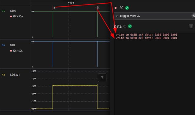

However, the LSOUT1 pin always remains at 3.3 V. I’d like to confirm whether the current nPM1300 Zephyr driver supports controlling the load switch (LDSW) via I²C instead of GPIO, or if I’m missing something in my configuration.
  • I don't see a reason why LDSW wouldn't disable in your situation.
    What version of NCS/Zephyr is this? I tried your code with latest Zephyr (with minor adjustments due to some API changes) just now, and this behaves as expected. Maybe there was a bug in an earlier version, so I can try whichever version you're developing with.
    One thing I could think of is the fact that according to Zephyr documentation, the `regulator_enable` function is a "Reference-counted request" (https://docs.zephyrproject.org/apidoc/latest/group__regulator__interface.html#ga06e3109b9607521fe07686c6d601e460). This means that if this function is called twice in a row, in order to disable said regulator one would need to call the disable function twice as well. So, maybe this somehow plays a role here, although I see that you check `regulator_is_enabled` each time before enabling or disabling it, so it shouldn't really happen...
  • Thanks for getting back to me! I’m using nRF Connect SDK 2.8 — both the SDK and toolchain are version 2.8. Could you try to reproduce my setup using NCS 2.8 and see if it works on your end?
  • Just tried your code without any modifications (only added `bias-pull-up` to the i2c pins configuration and commented out the sensor code since I don't have it) on 2.8, and I get the expected behavior again...
    If you have a logic analyzer, do you think you could examine the I2C lines during your code execution? You should see the writes as on the screenshot above. You will of course have more due to the sensor communication, but these are responsible for enabling and disabling the LDSW1 respectively.
  • I connected an oscilloscope to the LDSW1 output and found the issue. I had the sensor board already connected to the LDSW1 power output, and the board included a large decoupling capacitor. Because of that, when the sensor board was attached, I didn’t realize how slowly the LDSW1 was turning on and off—it gave the impression of a stable power output, since I was enabling the LDSW1 again quickly enough that the voltage level never had time to drop all the way to 0 V. That’s when I realized I needed to enable the active-discharge property on my LD1 regulator:
