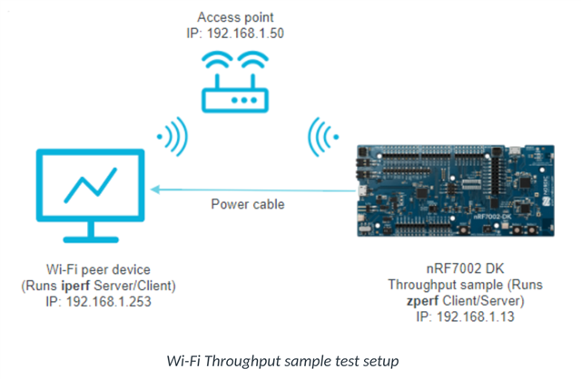

I noticed nordic provides Wi-Fi: Throughput to evaluate the throughput when device is working in STA mode.
If I want to evaluate the device in AP mode, is there any samples?

  • Hi again,
    So you can use the throughput sample for measuring the AP mode throughputs as well - just use the DK in SoftAP mode and use zperf shell command in the place of iperf (used with the COTS AP + connected PC).
    Elfving
