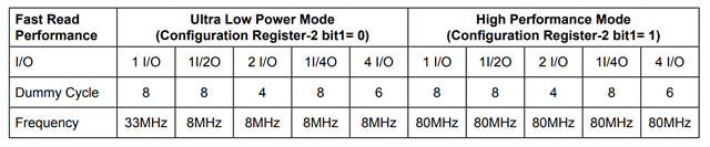

We have been testing/validating sQSPI on nRF54L15.
We tested the sQSPI on two versions of our nRF54L15DK (0.9.2 and 0.9.3).
We are using this sample app: https://github.com/zephyrproject-rtos/zephyr/tree/main/samples/drivers/spi_flash
And latest NCS 3.1.1 as of now.
sQSPI seems to work fine at lower frequency of 8 MHz.
However when we tested it at 64MHz, surprisingly only 0.9.2 version DK worked and 0.9.3 version DK did not work.
I understand from docs that 64 MHz sQSPI should work.
But we are not sure why sQSPI would not work on more latest 0.9.3 version DK.
Do you have any info on this or is this known issue?
Are we missing something on our 0.9.3 nRF54L15 DK or MX25R6435F flash that we should watch out for when using sQSPI at higher frequency?
Thanks for your support.
