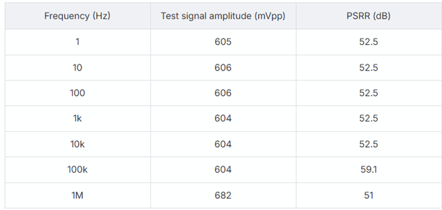

    From a PSRR point of view, powering the LDO from VSYS would be the better option, compared to powering it from the buck output. This is when considering that the buck is in hysteretic mode, where the ripple is higher when compared to PWM mode.
    Typical PSRR values in continuous reference mode (this means one of the bucks is in PWM, or charging is enabled):

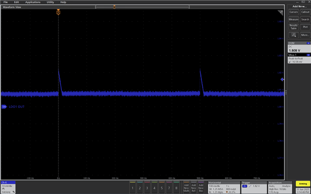

    In sampled mode (bucks in ULP mode and VBUS is disconnected), the LDO reference is sampled with a certain cadence to reduce current consumption. In this mode, the LDO output has some periodic ripple, see in the example below what the LDO output would look like with 1.8V output voltage and 10uA load.
    So, in this mode, the ripple caused by the sampled reference is dominating the PSRR, and thus, it wouldn't make sense to even measure the PSRR in this case.
