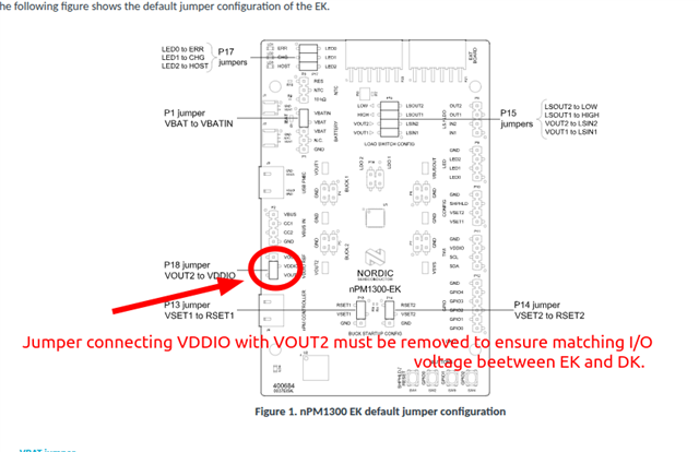

Without adding the npm1300.overlay or the Extra CMake argument, I see "PMIC device ok" (but no call back). However, when I add either the overlay or the cmake argument, I get "Error: led device is not ready"
I'm not sure where to go from here
I discussed this issue with one of the developers who pointed out the importance of following the connections outlined in the Wiring section. The jumper placements must be the same as the default placement except for the one on P18 as highlighted below.

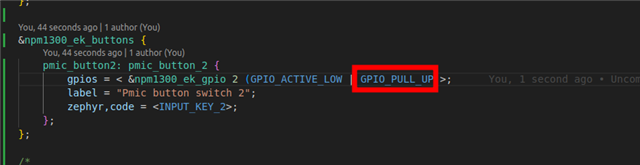

Another issue is that I had not enabled the internal pull-up on GPIO2. This can be fixed in the npm1300.overlay:
&npm1300_ek_buttons {
pmic_button2: pmic_button_2 {
gpios = < &npm1300_ek_gpio 2 (GPIO_ACTIVE_LOW | GPIO_PULL_UP)>;
label = "Pmic button switch 2";
zephyr,code = <INPUT_KEY_2>;
We will look into adding a picture of the EK with the correct jumper placements for this sample.
Vidar
It works now, thank you very much!

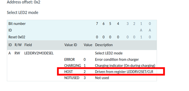

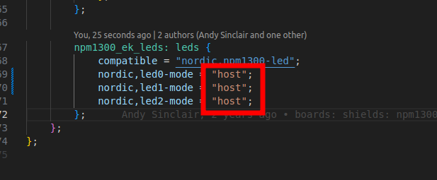

2. How can I blink a different led? The example, npm13xx_two_button blinks ld3 (host) with the commands: led_on(leds, 1U); and led_off(leds, 1U); I tried replacing the 1U with 0U, 2U and 3U, but with those values the leds do nothing.

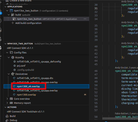

1.
I tried putting it in cmakelists.txt with set( SHIELD "npm1300_ek"), but that didn't do it.
This should work if it's placed before the find_package() line. Instead of including the shiled, you can also define your own board that includes the definitions from the overlay added by this shield:
https://github.com/nrfconnect/sdk-zephyr/blob/main/boards/shields/npm1300_ek/npm1300_ek.overlay
Or create an overlay for your existing build target (nrf52833dk_nrf52833.overlay) that includes the same definition as the npm1300_ek.overlay.

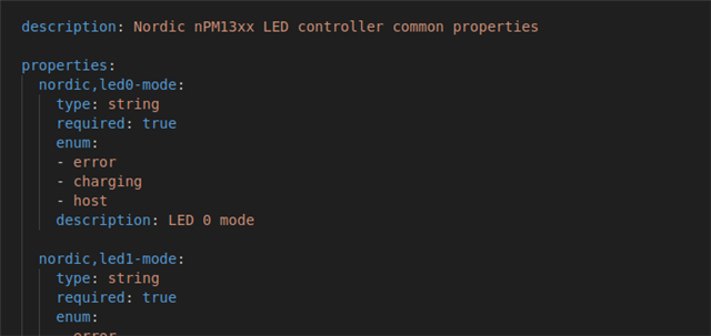

2. For the LED to be controllable it must configured in the host mode here:
The default mode can be selected by changing the overlay here:
Description of the properties from binding:
Vidar
Both of your solutions worked. Thank you

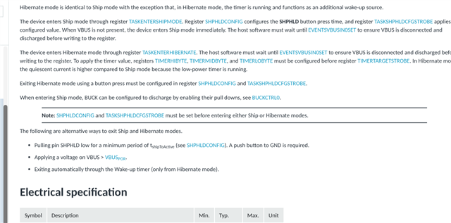

using the npm13xx_two_button project, is there a way to have the pmic come out of ship/hold after a longer button press? Right now it comes out on a short press, which I assume is the default.
I tried the following:
Thank you,
Keith
Hi Keith,
Please try to apply the configurations before entering shipmode as mentioned in the note here:
Vidar,
This is where I got the commands I'm using, but they don't work.
Hi Keith,
Yes, but the commands must be issued in the correct order.
