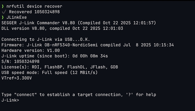

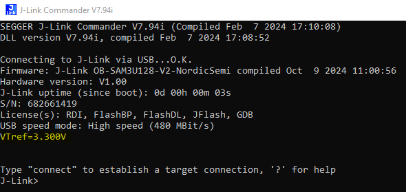

    Do you power both your cusbom board and the nRF52DK?
    What is the detected VTref value when you open the J-Link Commander?

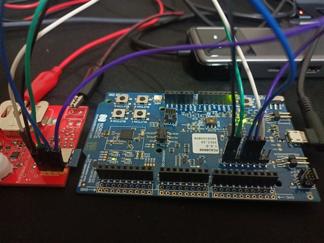

    All P20 connections (GND, SWDCLK, SWDIO, RESET) are wired correctly per the DK user guide.
    Check this post.

  • Here is JlinkExe and "nrfutils device recover" outputs:
    And here is my connections:

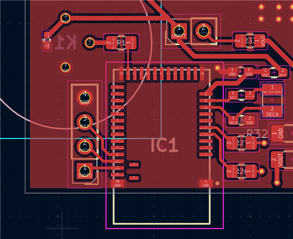

    Here is my PCB layout:
    The component between VBATT and VDD is 0R resistor. I guess this should be a problem.

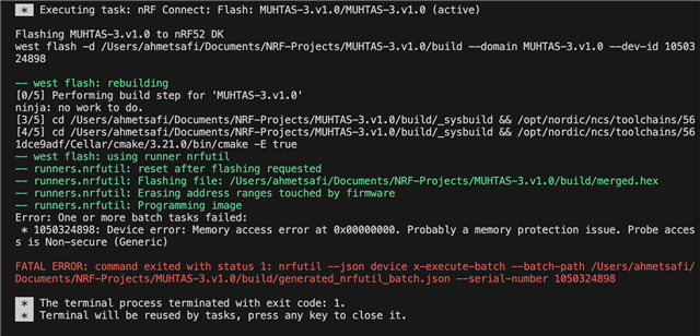

    Here is flashing log:
    I checked VTG pin with a multimeter and my custom board correctly provide 3 volts.
    Thanks you for you support I hope this will be enough to diagnose my problem.

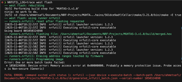

  • Could you run
    set NRFUTIL_LOG=trace
    west flash (or whatever invocation you used)
    in a terminal in vscode, and then send the log from <USERHOME>/.nrfutil/logs/nrfutil-device.log?
    via
    Here is flash command output
    And here is log file:

    Starting flash is erasing flash successfully I can not see my device on scan result after flash.
    Are you able to flash the image without issue now? If so, maybe you should check the device log or test the project on the nRF52DK.
    No, I cannot flash the image via west — only ST-Link is working. Thank you for your time and support. I’ve decided to stick with ST-Link, as I also found out that I can use RTT via Telnet to view the “LOG_INF” outputs. I believe I can complete my project using OpenOCD.
