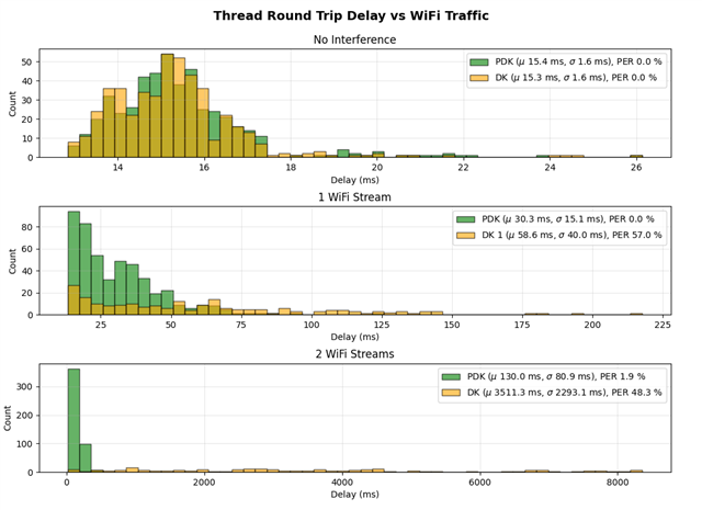

    Resistance to interference also appears to be lower, as indicated by a much higher PER for the DK compared to the PDK.
    Here is a comparison between the PDK and DK:
    ~470 Pings are sent with different Levels of WiFi Interference and the round trip time and PER are calculated.
    As the observation period is very short, no "statistics" can be established, but it does show a trend of a worse performing PK.

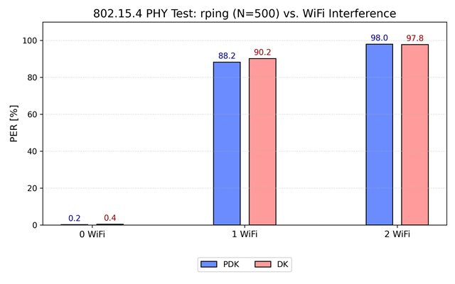

  • Do you see similar behavior with the IEEE 802.15.4 PHY test tool or Radio test (short-range) samples?
    I used the 802.15.4 PHY test tool and sent 500 rpings with different number of WiFi Interference Streams.
    The PER seems to be roughly the same between the DK and PDK:
    Although I'm not entirely sure how this test compares to the OpenThread measurement, as I am not quite aware of how the PHY/MAC differs (eg, number of retries)

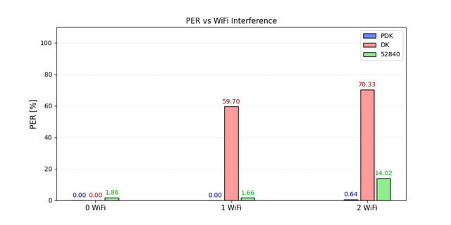

    We built the provided code for a nrf52840dk as well and repeated the test with different number of WiFi interference streams once more. This time we used a message length of 64. 470 Messages are sent, although the nrf54l15DK crashed after 337 messages:
    The nrf52840 (green) performs as expected and similar to the nrf54l15pdk (blue). The nrf54l15dk (red) performs worse.
