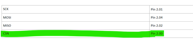

I tested using SPIS00 (or SPIS20) and pin equal to our board:
SCK
Pin 2.01
MOSI
Pin 2.04
MISO
Pin 2.02
CSN
Pin 2.00
I got the same behaviour, SPIS is stuck waiting EVENTS_END from Easy DMA
Then I tested using SPIS00 (or SPIS21) and pin
SCK
Pin 2.06
MOSI
Pin 2.09
MISO
Pin 2.08
CSN
Pin 2.10
This works fine, I can receive char from master correctly.

So the question is, why I can't use pin 00-04 of port 2 but I can use pin 06-10 of the same port? The are some limitation? But in this case why are not documented? I need some extra configuration that I miss? But in example + DK the configuration is the same.

    Thanks for contacting us. Please note that for different peripherals you have limited pin selection options. You can see the pin assignment page for more details about the restriction on selecting specific pins for different peripherals: Pin assignments
    f
    or CSN line you can use either P2.10 or P2.05 , P2.00 is not allowed.

  • Hi Ressa,
    tested using P2.05 on the DVK and it works.
    I checked for info about pins on the datasheet, but in v0.8 (version of document the we have) nothing was mentioned about SPIS CS, now in v1.0 (released september 25) is updated.
    The design for hw board is 3 months old, and so, without without specific advise, was used one of the available pin.
    Now need to modify the hw to test on the actual board.
    Thank you
