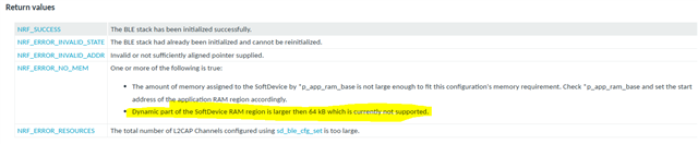

    rexxdad said:
    one outstanding issue, set number of peripherals 16 with larger buffer size, get ram_size 12400
    set in ld file, linker shows 12400
    sdh_ble_enable fails rc=4
    but it reports 12400 is needed
    is there a 64k limit?  Size under 64k works
    but I might have 30 or more of our devices to scan and talk to
    Yes, there is a limit, the dynamic part of the SoftDevice RAM region can be max 64 kB
    https://docs.nordicsemi.com/bundle/s140_v7.2.0_api/page/group_b_l_e_c_o_m_m_o_n_f_u_n_c_t_i_o_n_s.html#ga8a92420df90945526d4c89d09486508d

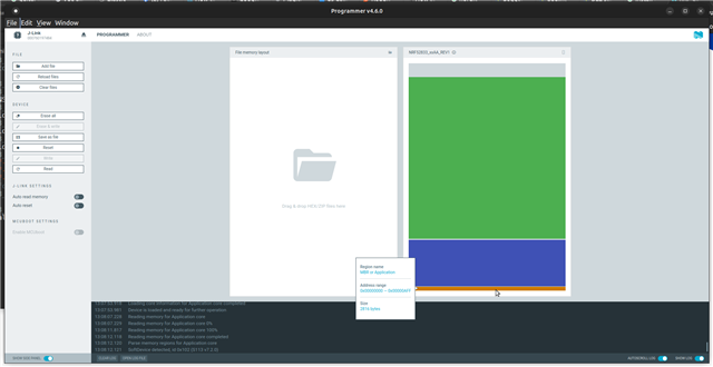

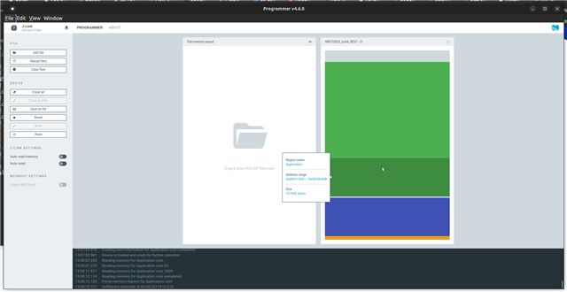

  • here are images from the nrfConnect Programmer tool after reading the memory of the 52833
    MBR
    softdevice
    app
