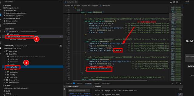

Power supply Config. 6 and software define
I used in my hw design Config. 6 for nRF52840 QIAA aQFN73
https://docs.nordicsemi.com/bundle/ps_nrf52840/page/ref_circuitry.html#ariaid-title7
The question is how to activate this configuration in the Zephyr software?
As I understand I should disable HV and DCDC. I tried to flash a few configurations, but NR52 stuck on start.
And the only way to reflash again is to apply to DEC4 1.3V.
