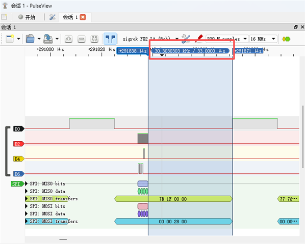

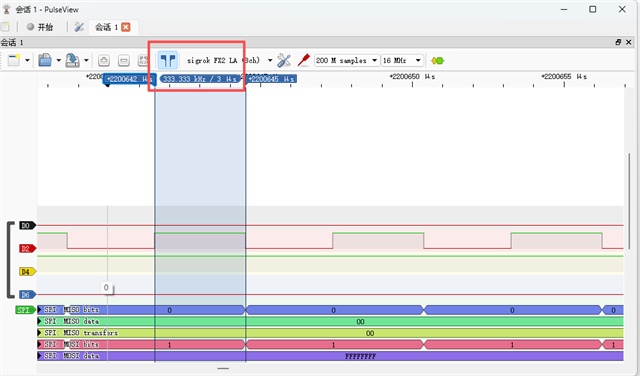

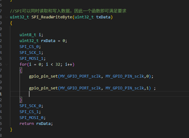

Hello, we are currently testing the output of square waves through GPIO output pins. However, I found that a single operation to set the GPIO output pin high or low using the gpio_pin_set function takes about 3 microseconds, so the transmitted square wave does not meet our speed requirements. I would like to know what is causing the slow GPIO output speed—is it the internal clock being too slow? Or too many parallel tasks? (In debug mode, the chip does not jump to other tasks and executes GPIO operations continuously.) Are there better GPIO configuration functions? Please provide us with assistance.
    1. include header hal/nrf_gpio.h and use nrf_gpio_pin_set / clear functions. These will write directly to the register.
    2. In addition; Try adding a barrier or a readback of an event register.
    Reading back for instance (void)NRF_TIMER2->EVENTS_COMPARE[0]; between each gpio_pin_set function call will generate a PCLK16M wait state, thus you will ensure that the gpio is set/clr with a higher accuracy/speed.
    Håkon
  • We followed your suggestion to directly write to the registers using the nrf_gpio_pin_set / clear functions, which improved the clock speed of our simulated SPI, but it's still insufficient. Therefore, I defined a timer interrupt function void TIMER2_IRQHandler(void) in an attempt to control the clock frequency myself. Although the program can run, according to the logic analyzer, this timer interrupt is not enabled. We currently have two hypotheses: first, there is no external clock source HFCLK; second, the timer2 timer is not triggering. Here are my current main file, configuration file, and device tree file. Could you please help me analyze the reason?

    uint32_t SPI_ReadByte(uint32_t rxData)
        uint32_t answer;
        answer=SPI_ReadWriteByte(rxData);
        return answer;
    void SPI_WriteByte(uint32_t txData)
        (void)SPI_ReadWriteByte(txData);

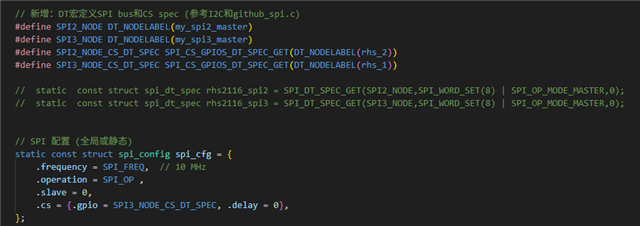

    // SPI 配置 (全局或静态)
    static const struct spi_config spi_cfg = {
        .frequency = SPI_FREQ,  // 10 MHz
        .operation = SPI_OP ,
        .slave = 0,
        .cs = NULL,  // CS 手动控制

    #define MY_GPIO_PIN_cs ((gpio_pin_t)15U)  // 自定义引脚 P0.14(uint32_t 类型)
    /* 手动定义:GPIO 端口(nRF5340 默认 gpio0)和引脚号 */
    #define MY_GPIO_PORT_sclk DEVICE_DT_GET(DT_NODELABEL(gpio0))  // 获取 gpio0 端口指针
    #define MY_GPIO_PIN_sclk ((gpio_pin_t)14U)  // 自定义引脚 P0.14(uint32_t 类型)
    #define MY_GPIO_PORT_mosi DEVICE_DT_GET(DT_NODELABEL(gpio0))  // 获取 gpio0 端口指针
    #define MY_GPIO_PIN_mosi ((gpio_pin_t)16U)  // 自定义引脚 P0.14(uint32_t 类型)
    #define MY_GPIO_PORT_miso DEVICE_DT_GET(DT_NODELABEL(gpio0))  // 获取 gpio0 端口指针
    #define MY_GPIO_PIN_miso ((gpio_pin_t)17U)// 自定义引脚 P0.14(uint32_t 类型)
    #define SPI_CS_1    nrf_gpio_pin_set( MY_GPIO_PIN_cs)            /* SCK = 1 */
    #define SPI_CS_0    nrf_gpio_pin_clear(MY_GPIO_PIN_cs)
    #define SPI_SCK_1    nrf_gpio_pin_set(MY_GPIO_PIN_sclk)            /* SCK = 1 */
    #define SPI_SCK_0    nrf_gpio_pin_clear(MY_GPIO_PIN_sclk)        /* SCK = 0 */
    #define SPI_MOSI_1     nrf_gpio_pin_set(MY_GPIO_PIN_mosi)           /* MOSI = 1 */
    #define SPI_MOSI_0     nrf_gpio_pin_clear(MY_GPIO_PIN_mosi)        /* MOSI = 0 */
    #define SPI_READ_MISO    nrf_gpio_pin_read( MY_GPIO_PIN_miso)    /* 读MISO口线状态 */
    void SPI_IoInit(void)
        /* 配置输出引脚:CS, SCK, MOSI 为输出,默认高电平 */
        nrf_gpio_cfg_output(MY_GPIO_PIN_cs);
        nrf_gpio_cfg_output(MY_GPIO_PIN_sclk);
        nrf_gpio_cfg_output(MY_GPIO_PIN_mosi);
        /* 配置输入引脚:MISO 为输入,无上拉/下拉 */
        nrf_gpio_cfg_input(MY_GPIO_PIN_miso, NRF_GPIO_PIN_NOPULL);
        SPI_CS_1;
        SPI_SCK_1;
        k_sleep(K_MSEC(10));
        SPI_MOSI_0;
    static volatile uint32_t spi_tx_data = 0;
    static volatile uint32_t spi_rx_data = 0;
    static volatile uint8_t spi_bit_pos = 0;
    static volatile bool spi_state = false;  // false: prep (falling), true: sample (rising)
    static volatile bool spi_transfer_complete = false;
    //SPI可以同时读取和写入数据,因此一个函数即可满足要求
    uint32_t SPI_ReadWriteByte(uint32_t txData)
      // 初始化状态
        spi_rx_data = 0;
        spi_bit_pos = 0;
        spi_state = false;
        spi_tx_data=txData;
        // CS low, initial SCK low, MOSI idle (will be set in first prep)
        SPI_CS_0;
        SPI_SCK_0;
        SPI_MOSI_0;  // Idle low
        NRF_TIMER2->EVENTS_COMPARE[0] = 0UL;  // 手动清事件(必须!)
        NRF_TIMER2->SHORTS = 0UL;             // 先清 SHORTS,避免预触发
      // 手动寄存器:设置 CC[0]=1 + SHORTS(自动清零)+ 中断使能 + 启动
        NRF_TIMER2->CC[0] = 15;                         // CC[0]=1 (125ns interval, 8 MHz events)
        NRF_TIMER2->SHORTS = (1UL << 0);               // SHORTS_COMPARE0_CLEAR (位0: 清零计数器)
        NRF_TIMER2->INTENSET = (1UL << 0);             // INTENSET_COMPARE0 (位0: 启用中断)
        NRF_TIMER2->TASKS_CLEAR = 1UL;                 // 清零计数器
        NRF_TIMER2->TASKS_START = 1UL;                 // 启动定时器
        // 等待传输完成(添加超时调试:避免无限挂)
        uint32_t timeout = 0;
        while (!spi_transfer_complete && timeout < 1000000) {  // ~1s 超时(调试用)
            __NOP();
            timeout++;
            if (timeout % 100000 == 0) {  // 每 10w 次检查
        if (timeout >= 1000000) {
            printk("SPI timeout! bit_pos=%d\n", spi_bit_pos);  // 调试:检查 ISR 执行
      // 手动寄存器:停止定时器 + 清除
        NRF_TIMER2->TASKS_STOP = 1UL;                  // 停止
        NRF_TIMER2->INTENCLR = (1UL << 0);             // 禁用中断
        // CS high, SCK low, MOSI low
        SPI_SCK_0;
        SPI_CS_1;
        SPI_MOSI_0;
        return spi_rx_data;
        if (NRF_TIMER2->EVENTS_COMPARE[0]) {
            NRF_TIMER2->EVENTS_COMPARE[0] = 0;  // 清除事件
            if (spi_bit_pos < 32) {
                if (!spi_state) {
                    // Prep phase (falling edge): Set MOSI for next bit, SCK low
                    SPI_SCK_0;
                    uint32_t tx_bit = (spi_tx_data >> (31 - spi_bit_pos)) & 1UL;
                    if (tx_bit) {
                        SPI_MOSI_1;
                    } else {
                        SPI_MOSI_0;
                    spi_bit_pos++;
                    spi_state = true;  // Next: rising
                } else {
                    // Sample phase (rising edge): Sample MISO, SCK high
                    SPI_SCK_1;
                    uint32_t miso_bit = SPI_READ_MISO;
                    spi_rx_data |= (miso_bit << (31 - (spi_bit_pos - 1)));  // Shift into MSB first
                    spi_state = false;  // Next: prep
            } else if (spi_bit_pos == 32) {
                // Transfer done: extra tick to finalize
                SPI_SCK_0;
                spi_transfer_complete = true;
                spi_bit_pos++;  // Prevent re-entry
        uint32_t answer;
        return answer;
    // 强制启动 HFCLK(Zephyr 默认管理,但 BLE 前确保)
    NRF_CLOCK->TASKS_HFCLKSTART = 1UL;
    while (!(NRF_CLOCK->EVENTS_HFCLKSTARTED));  // 等待 ~100us
    NRF_CLOCK->EVENTS_HFCLKSTARTED = 0UL;  // 清事件
    k_sleep(K_USEC(500));  // 额外稳定 (XTAL 需 200-500 μs)
    // 验证
    uint32_t hfstat = NRF_CLOCK->HFCLKSTAT;
    printk("HFCLKSTAT=0x%08X, Source=%u (expect 3=XTAL)\n", hfstat, (hfstat >> 16) & 0xFF);
    // 手动初始化 TIMER2(全局,一次性:无 nRFx 依赖)
    NRF_TIMER2->MODE = 0;                          // TIMER_MODE_TIMER (0)
    NRF_TIMER2->PRESCALER = 0;                     // No prescaling, 16 MHz counter
    NRF_TIMER2->BITMODE = 3;                       // TIMER_BITMODE_32Bit (3)
    IRQ_CONNECT(TIMER2_IRQn, 6, TIMER2_IRQHandler, NULL, 0);  // 优先级6(中),flags=0
    irq_enable(TIMER2_IRQn);  // 全局启用(代替NVIC_EnableIRQ)
    kevin
    HHJ said:
    First, let me reply to your first question. After using the nrf_gpio_pin_set / clear functions to directly write to the registers, our speed has reached 2.65 microseconds per complete clock cycle. Since we have a total of 32 clock cycles, the total time consumed is 84.8 microseconds. However, the 32 clock cycles of our hardware SPI can be completed in 4 microseconds. We don't need to reach such a high speed, but our 32 clock cycles should be controlled within 10-20 microseconds at least. Do you have any other methods to increase the speed?
    You need to change the gpio each 0.15 to 0.3 us to obtain a frequency of 3.2 to 6.4 MHz.
    This is not possible to do using the gpio directly. You need to use a dedicated hardware peripheral to do this.
    Håkon
  • We are currently using the SPI of the chip hardware without any modifications, directly reading the DTS file via macros, and setting the CS_delay to 0. Our clock is set to 8M, which works well (32 clocks take 4us), but the CS line pulls high 33us after the clock line ends. This makes a single SPI operation take 46us, resulting in the SPI frequency failing to meet our time requirements—since the time consumed by the CS line determines the final SPI frequency. This is quite unreasonable; why does such a strange phenomenon occur?
    You need a bit more flexibility and control over the hardware module.
    I would recommend that you look into using the nrfx_spim driver directly instead of using the zephyr driver.
    https://github.com/zephyrproject-rtos/hal_nordic/tree/master/nrfx/samples/src/nrfx_spim
    Håkon
