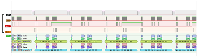

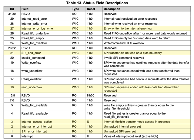

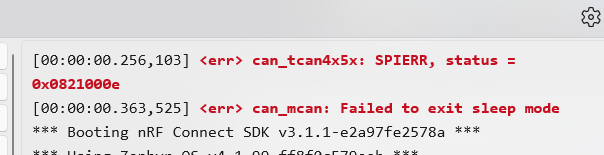

I am using VS Code to develop on the nRF52832, which is externally connected to a TCAN4550 CAN-FD chip. I successfully used the tcan4550evm.overlay to send and receive 8-byte CAN data normally. However, when I tried to send a CAN-FD format data packet, the operation failed. so,how to correctly send a CAN FD format data packet? I look forward to your reply.

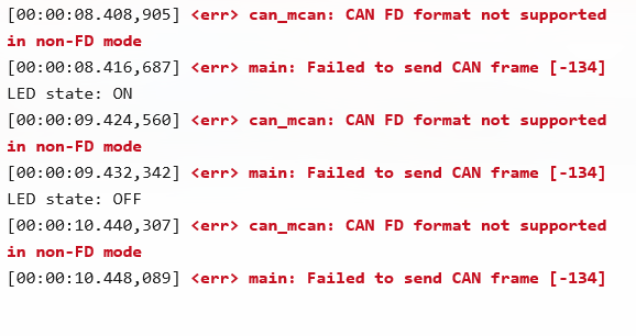

The printout shows the following error message.

        /* 5. 构造并发送一条CAN消息 */
        struct can_frame frame_to_send = {
            .id = 0x456,      /* 发送ID */
            /* CAN FD 帧标志,BRS表示使用更快的比特率传输数据段 */
            .flags = CAN_FRAME_FDF | CAN_FRAME_BRS,
            .dlc = 12,         /* 数据长度码, 9对应12字节. CAN FD DLC > 8 时有特殊含义 */
            .data = {0x01, 0x02, 0x03, 0x04, 0x05, 0x06, 0x07, 0x08,0x01, 0x02, 0x03, 0x04}
        frame_to_send.dlc = can_bytes_to_dlc(12); // 使用辅助函数将字节数转换为DLC值
        ret = can_send(can_dev, &frame_to_send, K_SECONDS(1), NULL, NULL);
        if (ret != 0) {
            LOG_ERR("Failed to send CAN frame [%d]", ret);
