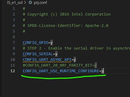

    Thanks for contacting us. Changing the parity for UART communication is supported. Please check DevAcademy to see if there is anything missing in your configuration.: UART Driver - Nordic Developer Academy
    Also please try to have either of below lines in your configuration file, I don't see any of them:
    CONFIG_UART_ASYNC_API=y

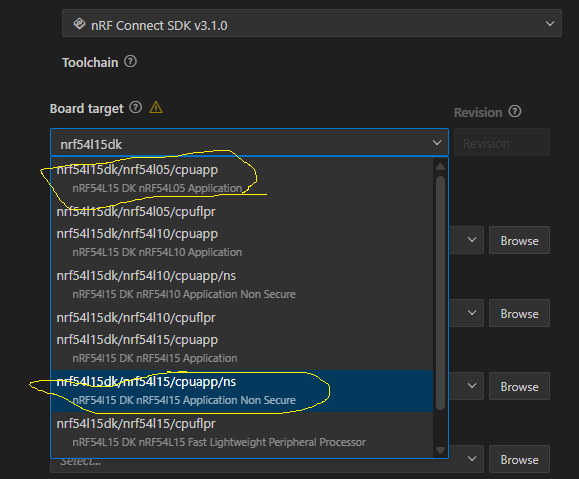

    Also try to use both secure and non secure builds in build configuration, to see if you see any difference:

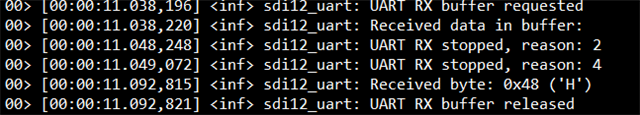

    I included:
    Couldn't receive anything on UART, so these made things worse.  Maybe because I'm using POLLING?

    Tried "secure" and "non-secure" builds... no change.

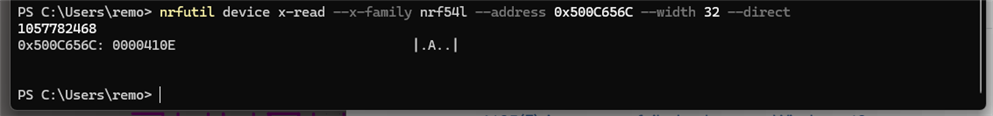

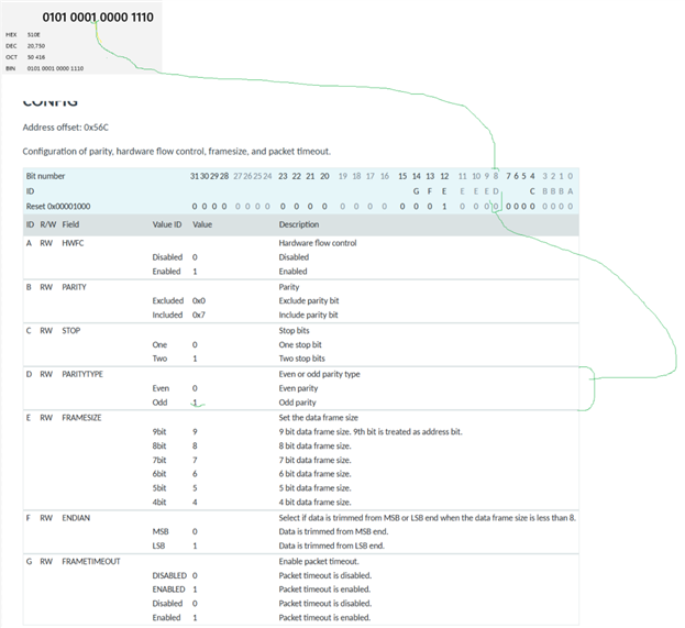

    After setting the parity mode, can you check the below register value by reading it directly from nRFUTIL, not sure if you are testing it on DK or not though, it gives good insight to see what is happening behind:
    UARTE — Universal asynchronous receiver/transmitter with EasyDMA
    The register address for UART20 setting is: 0x500C656C, by reading the value you can decode it by looking at above link. Or just share it here.
    You can also directly write to this register using nrfutil.
