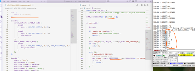

how to change nrf54l15dk console from uart20 to uart21?
hi,
I use nrf54l15dk with ncs-v3.1.0, the project is based sample "central_hids";

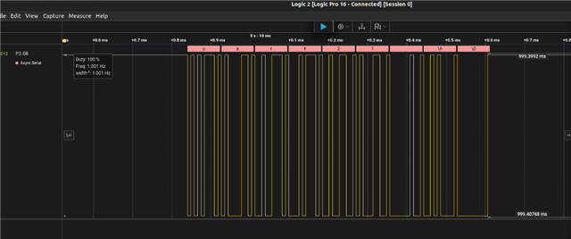

The purpose is I want to change console uart from "pin1.04/pin1.05<uart20>" to "pin2.07/pin2.08<uart21>";
If I change the overlay as below,and init <uart21> in main function;
It seems that the chip doesn't work;
If I change it back as default,It can work well with <uart20>
wish  for your reply,thank you;

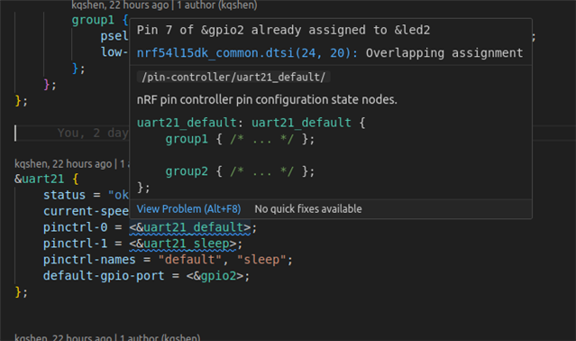

&uart20 {
    status = "disabled";
&led2 {

&uart21 {
    status = "okay";
    current-speed = <115200>;
    pinctrl-0 = <&uart21_default>;
    pinctrl-1 = <&uart21_sleep>;
    chosen {
        zephyr,console = &uart21;
        zephyr,shell-uart = &uart21;
//it's my init for uart21;
const struct device *uart = DEVICE_DT_GET(DT_NODELABEL(uart21));
int main(void){
    //it is I add in main function
	NRF_POWER->TASKS_CONSTLAT = 1;
	if (!device_is_ready(uart)){
    	return;
