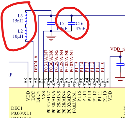

    The behavior you describe doesn't sound typical for when DCDC is enabled but the components are missing, as that usually locks the device up entirely, so I don't think that is it here. Can you say specifically which components you removed from your board? Did you just remove the two inductors or any additional components? There are three extra components added when DCDC is used, so those three should be removed with everything else being untouched:

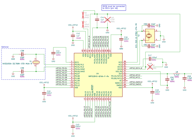

    Thank you for your reply. I only removed L2 and L3, not the C16. After removing C16, I can flash firmware to the chip without error. But it seems the firmware is not running. I have attached my schematic here, could you please review it?
    About firmware, I'm using NCS v2.9.1, and using default setting now. When run debugging, it found out that under POWER, register DCDCEN has value 1 which is Enabled, and DCDCEN0 has value 0 which is Disabled. Is it the expected value?
  • Hi
    The schematics look good. Both DCDCEN registers should be set to 0 (disabled). This should be disabled by default AFAIK, but you can set &reg0 { regulator-initial-mode = <NRF5X_REG_MODE_LDO>; }; to make sure as well. Note that if it has been run with DCDCEN0 enabled at all without the required components, it not certain that you'll be able to reflash the device.
