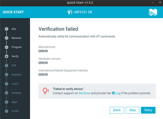

nRF9161 DK: Fails to verify device in QuickStart 1.5.2
I can no longer use AT commands on my nRF9161 DK development board.
It used to work perfectly, but I don't know what happened.

Here are the logs:
2025-11-11T11:35:12.603Z INFO Initialising the bundled nrfutil device
2025-11-11T11:35:12.610Z DEBUG Started watching devices
2025-11-11T11:35:12.733Z INFO Using the bundled core version for nrfutil device: 8.1.1
2025-11-11T11:35:12.830Z INFO Using nrfutil device version: 2.13.2
2025-11-11T11:35:12.831Z INFO Using nrf-device-lib version: 0.19.0
2025-11-11T11:35:12.831Z INFO Using nrf-probe version: 0.45.0
2025-11-11T11:35:12.831Z INFO Using SEGGER J-Link version: JLink_V8.66
2025-11-11T11:35:12.831Z INFO Your version of SEGGER J-Link (8.66) is newer than the one this app was tested with (8.60). The tested version is not required, and your J-Link version will most likely work fine. If you get issues related to J-Link with your devices, use the tested version.
2025-11-11T11:35:15.604Z DEBUG Selected device: nRF9161 DK
2025-11-11T11:35:15.638Z DEBUG Changed step: Info
2025-11-11T11:35:17.478Z DEBUG Changed step: Rename
2025-11-11T11:35:18.332Z DEBUG Changed step: Program
2025-11-11T11:36:40.432Z DEBUG Changed step: Verify
2025-11-11T11:36:43.435Z INFO Opened port with options: {"path":"/dev/ttyACM0","baudRate":115200}
2025-11-11T11:36:45.436Z ERROR Received ERROR as return value from AT command
2025-11-11T11:36:45.439Z INFO Closed port: /dev/ttyACM0

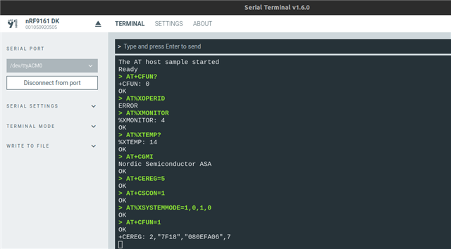

    I can't reproduce the error on my side. Can you please share which program you flashed into the dk?
    Also, if you connect a serial terminal while doing the quick start, you should be able to see the AT commands being sent to the device.
    You should see something like that:
    Can you confirm that you see the AT commands?

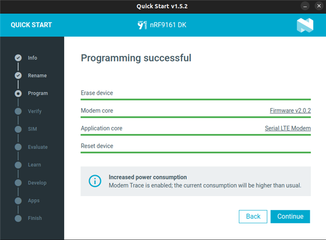

  • Thank you for your reply .
    i'm following this course again :
    cellular-iot-fundamentals/lessons/lesson-2-cellular-fundamentals/topic/lesson-2-exercise-1/

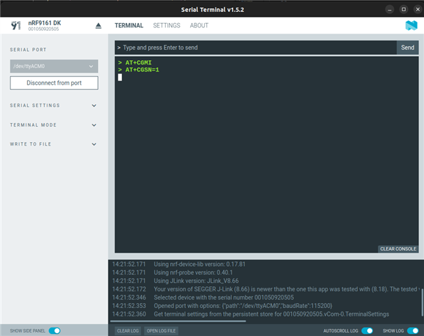

    Here are some more screenshots after flashing the AT command application program:
    Skip and open terminal
    When I send AT commands, I receive no response.

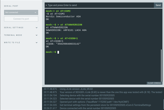

  • Thanks for your suggestions. Unfortunately, the issue is still present after applying all your suggested fixes.
    To summarize the situation and the troubleshooting steps taken:
    • The "blinky" and "helloworld" samples work fine, confirming basic board functionality.
    • I usually turn on/off my PC.
    • I downgraded the software to v8.60 but still have the same issue.
    • I also recovered the board with the command nrfutil device recover.
    The weird thing that I observed is that when I flash the "asset tracker" program onto the board, I'm able to retrieve board information (not through AT command, but just visual display).
    Thank you for your continued assistance.
    Here is the log related to AT-command program:

  • The weird thing that I observed is that when I flash the "asset tracker" program onto the board, I'm able to retrieve board information (not through AT command, but just visual display).
    I'm not sure to understand what you mean by visual display... Do you mean in the serial terminal ? If not, do you see anything in the serial terminal ?
    And which "asset tracker" are you refering to, the "Legacy Asset Tracker" (Asset Tracker v2) or the "Asset Tracker" (Asset Tracker Template) ?
    One more thing you can try, if you have access to an other computer, is to do the quick start on that other computer.
