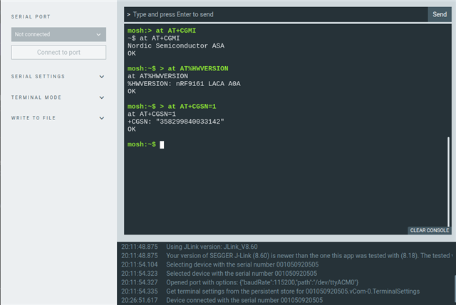

    Just to check if you are doing something wrong, tell me each and every step you are doing through the quick start. Also open an nRF Connect for desktop Serial Terminal and connect it to the device before starting the quick start, and leave it open through the whole process.

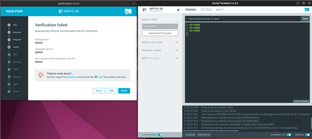

    Here is the console output of the whole process :
    I've tried several times, but there's still no response, as you can see on the console.

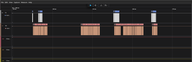

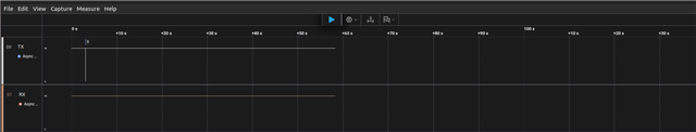

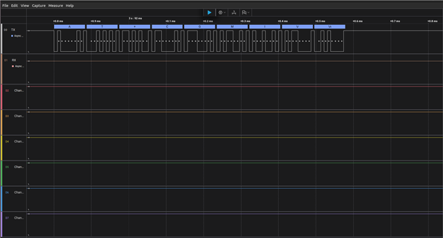

  • As you suggested, here are the signal analyzer screenshots.
    -  "AT command" program:
    -  "Shell Command Line Interface" program
    Fabrice
    From what I can see, it is indeed working correctly.
    dfdl said:
    I can see that it is answering correctly to the AT commands, is the problem still here?
    Is it only happening with the quick start's AT command app ?
    When you build and program a sample that supports AT commands, does it work ?
