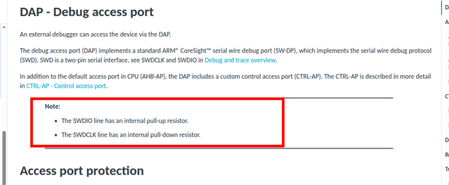

Is there any way to recover the nrf chip and the debug access port?
Thanks in advance,
Antoine

    Also, the led on the jlink probe is always in orange color, which means that the reset signal is always active.
    Does It look like an HW failure?
  • With nRESET enabled on the pin (CONFIG_GPIO_AS_PINRESET), the internal pull up will be enabled so it should not be floating, even if you didnt have an external pull up.

    Have you tried to measure if the reset line is pulled low externally? For instance by measuring the resistance between the pad and ground?
