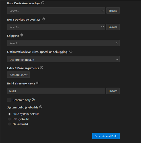

    I'm using the vs code nrf connect. In that extension i'm adding the generate build option intially. then if i want to build, I will use build option in nrf connect extension.

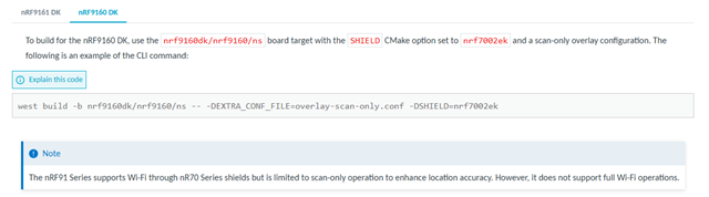

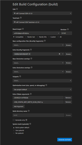

  • I was able to reproduce the issue with your settings, which are wrong. If you have a nRF7002EK shield you need to add shield to the build configuration, please see my screenshot here
    You must add the following:
    Let me know how that works for you.
    Øyvind
  • I can build the project, can you please me the pin configuration for this example. Please find the below logs.
    *** Booting nRF Connect SDK v3.1.0-6c6e5b32496e ***
