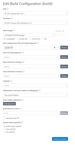

    This is the build configuration:
    The build completes successfully:
     *  Executing task: nRF Connect: Build [pristine]: bap_broadcast_source/build (active)
    Building bap_broadcast_source
    west build --build-dir c:/workspace/Nordic/bap_broadcast_source/build c:/workspace/Nordic/bap_broadcast_source --pristine --board nrf5340dk/nrf5340/cpuapp --no-sysbuild -- -DCONF_FILE="prj.conf"

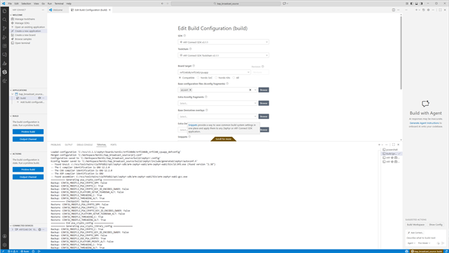

    But I am not then presented with a Flash option for the connected nRF5340 DK board:
    What am I missing please?

  • Hi Dejan,
    I did not flash the board as no option to do so under either the Actions of Connected Board section is presented, this is the point I am querying. Once I have successfully built a project, I would normally expect to see Flash as one of the available options. Why don’t I see it please?
