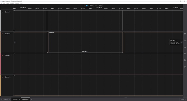

Controlling LED through pwm using nrfx or other offloading way for nrf54l15
I am trying to do pwm a rgb led using nrf54l15dk and custom board using nrf54l15 on port1 with pin connections on (p1.10, p1.8 and p1.13 for custom) or on (p1.11, p1.12 and p1.10 for nrf54l15dk).
So, on nrf54l15dk I am able to do pwm using pwm_set_dt command, but it consumes CPU cycles so, I want to move that to nrf_pwm_sequence_t command which works fine in nrf52840. When I tried nrf_pwm_sequence_t it did not modulate pulse which it should do.
I tried doing using both common and individual load, still no luck.

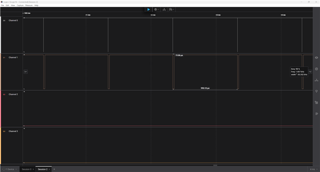

  • Hi!
    Could you elaborate on this? You need to call pwm_set_dt() very often to get the desired signal?
  • Yes, when I use pwm_set_dt with different duty cycle, I am able to see different led intensity and when placed inside a while or for loop with changing duty cycle, I am able to get a pulse led for a desired time and speed.
    Like I am able to set led pulse of 3 sec running for 10 sec or desired time or the loop is true.
    But, using this method for pwm, CPU needs to update and send that command to pin which is power consuming. So, I found a way that in nrf52840, but using nrfx_sequence, I can reduce power consumption and CPU can work on other tasks.
    So, while porting to nrf54l15, I am unable to load off that task to nrfx_sequence. So, I am trying to find a way to work with nrfx_sequence in nrf54l15.

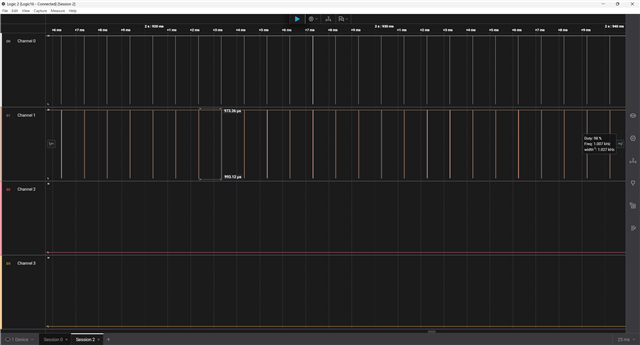

  • Hi!
    Maybe you can do it like this:

    [00:00:00.012,505] <err> tests_pwm_example: PWM complex playback failed: 0
    I searched for the playback failed: 0 reason and found this
    "PWM complex playback failed: 0, indicates that the function nrfx_pwm_complex_playback is returning 0. The return value of nrfx_pwm_complex_playback is not an error code, but rather the address of the task to be triggered if the NRFX_PWM_FLAG_START_VIA_TASK flag is used. If this flag is not used, the function returns 0, which is expected and does not indicate an error."
    and here is the logic analyzer output for pin 1.11 and 1.12
    as you can see the pwm is almost same for all signals, and that's the reason I am unable to see any pulse or blinking effect.
