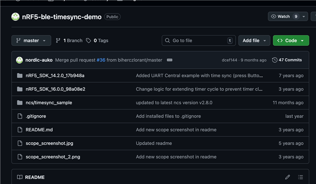

    No that sample seems to be for the old nRF5 SDK (see here). The nRF54 series only support the nRF Connect SDK. See here instead.
    Elfving

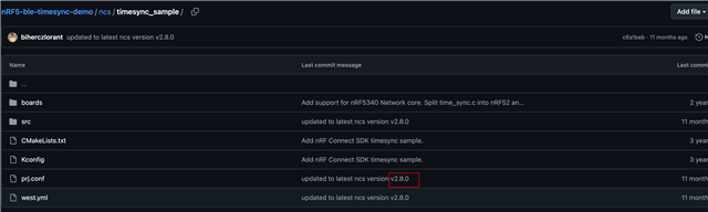

    There is a ncs 2.8 version in this github.
    And I found this code claim to support nrf52832/nrf52840 and nrf5340. I can only compile nrf52 series. 53's code can not be compiled. What would be the reason?
    I am also wondering whether the new nRF54L15 can use this code. I guess some new feature will block this function. Could you help me on this issue?
