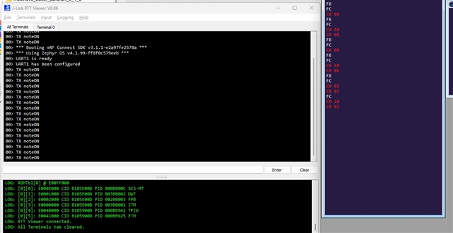

  • I started again. The following code is successfully transmitting data to my PC via a cable connected to the daughter board. No errors are returned during device configuration. But the data values reported at the PC end are not the same as those transmitted from my code.
    // main.c
    #include <zephyr/kernel.h>
    #include <zephyr/drivers/uart.h>
    /* Get UART1 device */
    static const struct device *uart = DEVICE_DT_GET(DT_NODELABEL(uart1));
    static uint8_t noteON [3] = {144, 48, 100};
    static uint8_t noteOFF [3] = {128, 48, 100};
            if (!device_is_ready(uart)) {
                    printk("ERROR: uart1 is not ready\n");
                    return -1;
            printk("UART1 is ready\n");
    	/* UART configuration */
    	const struct uart_config uart_cfg = {
    		.baudrate = 31250,

    The fact that there is evidence of transmission of data and it being received suggests I've created a UART1 device OK and the pin selected for TX is correct (I've not looked into RX yet).
    I can only think that the mismatch between values sent and received suggests that the serial config of the two endpoints are not the same. Are there any other possibilities? The cable I'm using is a 5-pin DIN MIDI to MIDI over USB converter and it is identified by Windows 11 as expected as a MIDI device. I've used it many times with MIDI equipment so have confidence in the cable and it being correctly registered as a device and configured by Windows. Unfortunately, Windows doesn't seem to let me get at the serial port device that sits under the MIDI device so I can't actually see the configuration. But given I know this usually works, I am not too concerned about this.
    That leaves the Zephyr end of things. Any ideas? It feels like I'm close now!

  • More information on this:
    My Adafruit Feather nRF52840 has a MIDI daughter board with 5-pin DIN sockets. I have its MIDI OUT connected to my PC using a special adapter cable. The USB end has active electronics which cause Windows to register it as a MIDI device. This has prevented me from engaging directly with the serial communications using (say) a terminal. Instead I use a MIDI monitor application to see the data being received.
    I've now got the Adafruit Feather connected to the serial interface of a Raspberry Pi rather than a Windows PC and have a simple script reading directly from the serial port and printing the bytes received from the Adafruit Feather. I've tried various baud rates but none result in the expected values being received and printed.
