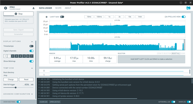

I’m testing low-power behavior on an nRF52811 device.
  • When SoftDevice is not enabled, calling nrf_pwr_mgmt_run() gives me a stable ~5 µA average with no visible spikes — working as expected.

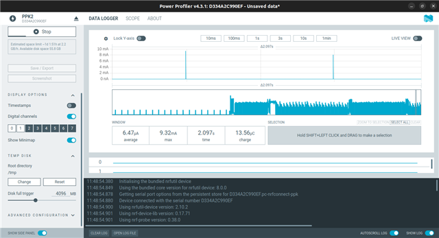

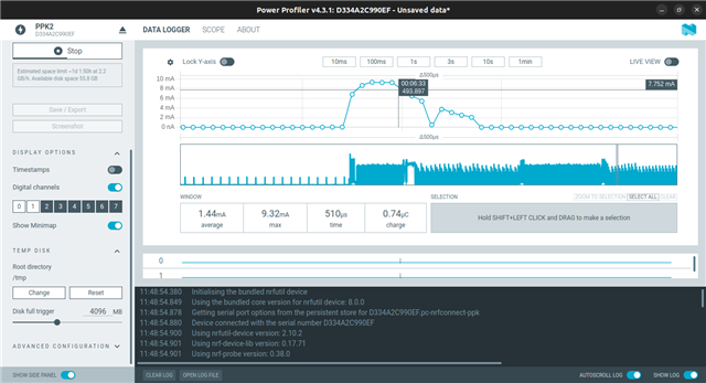

  • When SoftDevice is enabled, the average current is around 5.7 µA (which is fine), but I see current spikes of ~4 mA for ~100 µs every 1 second.
I want to avoid these periodic spikes.
Questions:
  1. What SoftDevice activity causes these ~1 s internal wakeups and 4 mA spikes, and how can I disable or suppress them?
    • I’m not doing any advertising or connections.
    • this state is after ble_adv_idle event
  2. What is the lowest achievable sleep current with the SoftDevice enabled, without any external interrupts?
    • Is ~5–6 µA the expected minimum?
    • Can the periodic wakeups be completely eliminated?
Any guidance on configuration, SoftDevice settings, or required API calls to reach minimum sleep current would be helpful.
Thanks!

i don't get spikes if use ble blinky example ,
posted images are from nrf52840 dk
