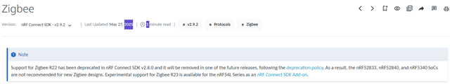

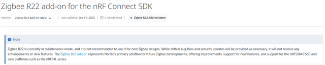

  • Hi Swathy,
    We came across information on the Nordic website indicating that the R23 Add-on is just an experimental support package that can be used for developing Zigbee applications. Please find the attached screenshot along with the reference link for your review:
    "docs.nordicsemi.com/.../index.html"
    Additionally, we found another document stating that the R23 Add-on is Nordic’s primary solution for future Zigbee developments, providing enhancements, new feature support, and compatibility with both the nRF52840 SoC and newer platforms such as the nRF54L Series. The corresponding screenshot and reference"docs.nordicsemi.com/.../index.html"
    In this context, we would like to confirm whether we can proceed with the Zigbee R23 Add-on package on the nRF52840 SoC for our development. Specifically, we seek clarification on its stability and suitability for long-term product deployment.

  • Hi Ajay,
    Sorry for the delay.  You can proceed with the Zigbee R23 Add-on package for development on the nRF52840 SoC. The solution is now production-ready (from v1.0.0 onwards). See here: https://docs.nordicsemi.com/bundle/addon-zigbee-r23-latest/page/software-maturity.html
    As I mentioned before, it is better to stay on v2.9.2, but it may work with later versions as well.. We have added experimental support for nRF54LM20A : GitHub - nrfconnect/ncs-zigbee at nrf54lm20-support which has been updated to be used with v3.1.0
